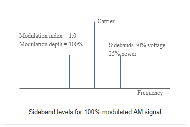

**Author:** ![VK2AAF](https://avatars.discourse-cdn.com/v4/letter/v/9f8e36/32.png) [@VK2AAF](https://community.sparkfun.com/u/VK2AAF)\
**Post date:** [August 5, 2025, 5:42am UTC](https://community.sparkfun.com/t/amateur-radio-beacon-transmitter-144mhz-band/66219/20 "2025-08-05T05:42:26Z")
An unmodulated carrier is the narrowest bandwidth and thus most power efficient way to send a radio signal. The amplitude power is consistent thus easy to measure and to identify the character of propagation on a given signal path.
A beacon needs only to demonstrate signal propagation. Modulation is unnecessary. CW is sufficient to send an ID of the transmitter. The 30 sec dead (unmodulated) carrier gives receiving stations an opportunity to aim directional antennas for maximum signal and identify the general location of the beacon.
WWV is amplitude modulated, even the time ticks. When you amplitude modulate (AM) a carrier, 2/3 of the signal is unnecessary. One sideband contains all the intelligibility information.
 ![image](https://canada1.discourse-cdn.com/sparkfun/original/2X/f/f458fde7d7d9aaa207a8e38430f73d8ba4e39518.png)
Just filter out the carrier and one sideband before amplifying and transmitting it. The carrier can be re-inserted in the receiver with a BFO. The result is known as SSB (single sideband).
However, SSB is trickier for non-technically oriented people to receive. First the frequency must be found, then the BFO must be adjusted to produce an intelligible signal.
