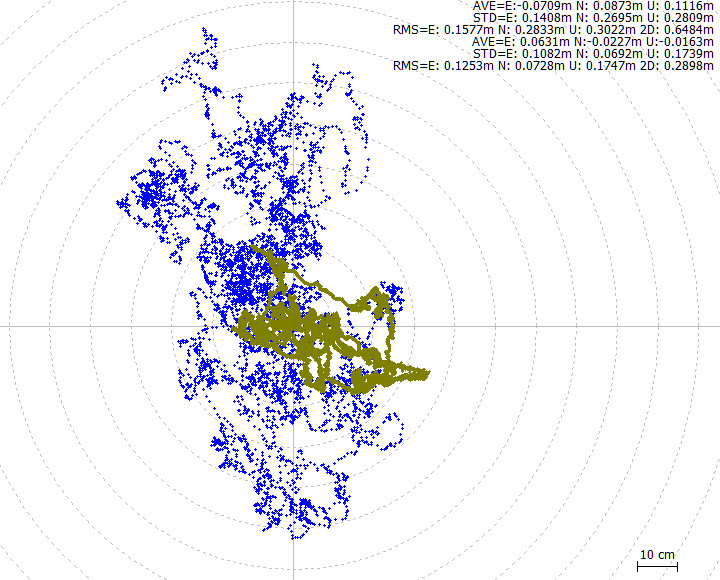

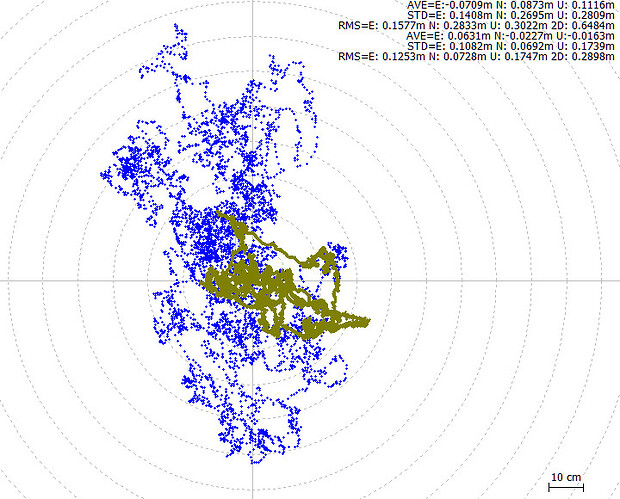

**Author:** ![jpb](https://avatars.discourse-cdn.com/v4/letter/j/f475e1/32.png) [@jpb](https://community.sparkfun.com/u/jpb)\
**Post date:** [September 4, 2025, 11:57pm UTC](https://community.sparkfun.com/t/beta-firmware-v03-0812-support-for-has-on-lg290p/66725/51 "2025-09-04T23:57:26Z")
Here’s a 23 hour static plot after convergence of the LG290P in HAS mode and a Septentrio Mosaic receiver in WAAS mode. The same antenna fed both receivers.
A horizontal 95% accuracy figure of 65 cm is typical for WAAS. While 29 cm for HAS is certainly better it’s on the high side compared to what I’ve seen in more than 50 days of Unicore UM980 HAS data.
Of course this is a beta version so I’m going to wait before doing any serious testing.

**Author:** ![amlago](https://yyz1.discourse-cdn.com/sparkfun/user_avatar/community.sparkfun.com/amlago/32/6128_2.png) [@amlago](https://community.sparkfun.com/u/amlago)\
**Post date:** [September 5, 2025, 12:29am UTC](https://community.sparkfun.com/t/beta-firmware-v03-0812-support-for-has-on-lg290p/66725/52 "2025-09-05T00:29:21Z")
Hi @jpb
Good data series.
Is the center of your diagram the average of the data, or are the coordinates obtained by another method?
Have you analyzed the deviations from the point’s true position?
I can’t leave the postcard on the roof of my house for as many hours as you can, but when I can, I’ll leave it for up to 6 hours. I’ll continue to report the data.
**Author:** ![rftop](https://yyz1.discourse-cdn.com/sparkfun/user_avatar/community.sparkfun.com/rftop/32/6121_2.png) [@rftop](https://community.sparkfun.com/u/rftop)\
**Post date:** [September 5, 2025, 1:07am UTC](https://community.sparkfun.com/t/beta-firmware-v03-0812-support-for-has-on-lg290p/66725/53 "2025-09-05T01:07:30Z")
@jpb shared some good data…..so we can get a little deeper in the analysis.
For that data set, I would start to have some confidence in a single real-time position being within 40cm, if we are assuming the center of the plot is the truth. This is very promising 😁
A trap that we fall into when considering real-time positions is inferring too much with many positions produced over long occupation times. The math is basically the same but how you apply it is different that how we evaluate a static session. Averaging all these points does produce a higher accuracy….but that’s not a true evaluation and doesn’t match the application of a real-time procedure. Averaging a days worth of epochs doesn’t increase the precision for a real-time application, only the accuracy when all points are combined.
Another way to say the same thing: With HAS, we aren’t getting atmospheric corrections. So for now we are stuck with those random errors. Averaging many points is how we cancel random errors, but that’s not a possibility for real-time work.
In the end We need to be able to say with confidence: _“Anytime I have PPP Convergence with HAS (or any correction source), the real-time position is within XX cm for This Device.”_ That’s any single epoch…..and that’s the hard part. Plus, the device must be able to reproduce that accuracy after dumping the antenna, and tomorrow, and the next day.
This is one reason why I love this tech. You can dive as deep as you want to and learn more every day.
I think @jpb‘s latest data is defendable to 40cm for that day. I like it and I can’t wait for that to tighten up. I haven’t been able to get repeatable real-time HAS accuracy over the long term…..yet 😉
