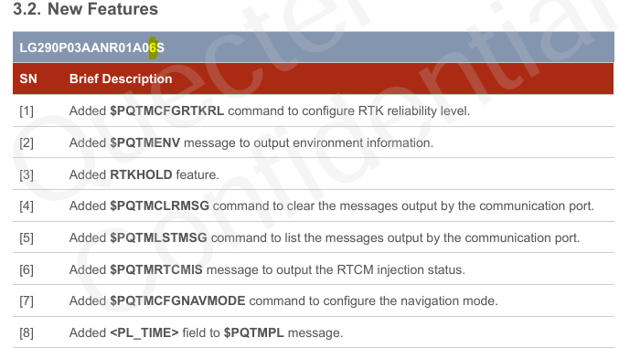

**Author:** ![amlago](https://yyz1.discourse-cdn.com/sparkfun/user_avatar/community.sparkfun.com/amlago/32/6128_2.png) [@amlago](https://community.sparkfun.com/u/amlago)\
**Post date:** [October 20, 2025, 2:55pm UTC](https://community.sparkfun.com/t/beta-firmware-v06-0829-support-for-has-on-lg290p/66858/18 "2025-10-20T14:55:58Z")
Hello friends.
Quectel sent me version 06 for LG290p following my email request, but we still don’t have any fixes for Galileo HAS.
In other words, we’re testing a version 06 with Galileo HAS provided by Sparkfun, but the final version they’re sending doesn’t have anything to do with PPP.
Another step backward.
If you know anything else, please let me know.
[LG290P03AANR01A06S.txt](https://community.sparkfun.com/uploads/short-url/gpFGPzBAxGEoBEhAxLoA87xBOfI.txt) (2.6 MB)
It’s a .zip file. I put it in .txt so I could upload it.
It’s the zip file sent by Quectel.
**Author:** ![rftop](https://yyz1.discourse-cdn.com/sparkfun/user_avatar/community.sparkfun.com/rftop/32/6121_2.png) [@rftop](https://community.sparkfun.com/u/rftop)\
**Post date:** [October 20, 2025, 3:33pm UTC](https://community.sparkfun.com/t/beta-firmware-v06-0829-support-for-has-on-lg290p/66858/19 "2025-10-20T15:33:24Z")
@amlago, thanks for sharing !
It appears Quectel wasn’t ready to finalize HAS support into V6 just yet.
RTKHOLD was a higher priority, or at least it was easier to implement.
 ![image](https://canada1.discourse-cdn.com/sparkfun/original/2X/6/61330dbbaa13b55f580aabc62f6a62be2c7382a3.png)
 ![image](https://canada1.discourse-cdn.com/sparkfun/original/2X/c/c7b735efb464480c8858f2425710c388d55d987e.png)
