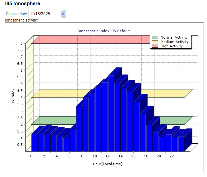

**Author:** ![rftop](https://yyz1.discourse-cdn.com/sparkfun/user_avatar/community.sparkfun.com/rftop/32/6121_2.png) [@rftop](https://community.sparkfun.com/u/rftop)\
**Post date:** [November 19, 2025, 4:02pm UTC](https://community.sparkfun.com/t/beta-firmware-v06-0829-support-for-has-on-lg290p/66858/64 "2025-11-19T16:02:28Z")
> [@amlago](#):
> It shouldn’t have a reported accuracy of 10 cm and actually be off by 40 cm.
That’s always going to be the situation for any GNSS device. It never knows the true location to calculate accuracy…and never will. The _“10cm reported accuracy”_ is just an educated guess. It’s basically an estimate based on how well the current solution aligns with recent epochs, nothing magical 😬
**Solar Activity** (worth it’s own Thread):
I look at 2 main sources when using GNSS, but especially when testing.
- The Total Electron Content -
[Global Positioning System (GPS) Community Dashboard | NOAA / NWS Space Weather Prediction Center](https://www.swpc.noaa.gov/communities/global-positioning-system-gps-community-dashboard)
When you go to the NOAA page, Pless Play on the Video (screenshot below), Times are Zulu. You can see the L1 Range error can change rapidly in just 1 Hour.
- I95 Ionosphere -
But the best source for me is our StateWide CORS network. That network reports the I95 Index, local. If you can find a local I95 Index, it can sometimes give you a good answer when positions start bouncing around, or when a receiver takes longer for RTK Fixed solution, etc.

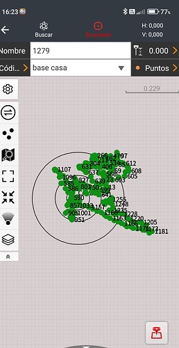

**Author:** ![amlago](https://yyz1.discourse-cdn.com/sparkfun/user_avatar/community.sparkfun.com/amlago/32/6128_2.png) [@amlago](https://community.sparkfun.com/u/amlago)\
**Post date:** [November 19, 2025, 7:29pm UTC](https://community.sparkfun.com/t/beta-firmware-v06-0829-support-for-has-on-lg290p/66858/66 "2025-11-19T19:29:35Z")
Today’s image
3.5 hours of data every 10 seconds
Circles from 0.05 m to 0.20 m
 ![Screenshot_2025-11-19-16-23-54-137_com.huace.landstar7~2](https://canada1.discourse-cdn.com/sparkfun/original/2X/d/d80befbda20400cb5e6f3a2a3c280a3c30e98771.jpeg)

**Author:** ![bamarcant](https://yyz1.discourse-cdn.com/sparkfun/user_avatar/community.sparkfun.com/bamarcant/32/9152_2.png) [@bamarcant](https://community.sparkfun.com/u/bamarcant)\
**Post date:** [November 20, 2025, 6:32pm UTC](https://community.sparkfun.com/t/beta-firmware-v06-0829-support-for-has-on-lg290p/66858/70 "2025-11-20T18:32:02Z")
Let’s say that if 5/6 hours are enough to carry out a survey, then we can proceed, but remember to re-reference everything relative to the field logbook for that specific session. I specify this because the position shifts with the daily change…here a 5 hour of static HAS position.
Again thanks to @sparky for allowing this.
 ![immagine](https://canada1.discourse-cdn.com/sparkfun/original/2X/4/4ccd80c7d070d5387b3986c6c30de9504128a75c.png)
**Post date:** [November 20, 2025, 8:54pm UTC](https://community.sparkfun.com/t/beta-firmware-v06-0829-support-for-has-on-lg290p/66858/71 "2025-11-20T20:54:27Z")
Hi @bamarcant
What antenna are you using?
I suspect some of the outages I’ve had might be due to using a small helical antenna.
