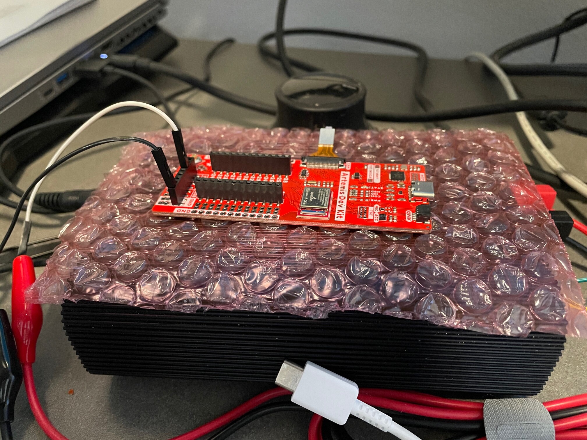

    Tried running Robin’s code as well as the sample ones on an Artemis Dev Kit. I’ve desoldered all of the leds as well as the microphone, but the lowest I can get it to sleep at is 12.1mA. I am using an Otii Arc to provide power and measure the draw by feeding 3.7v into the 3.3v and GND pins on the board as there is no MEAS on the Dev Kit.
    Is there anything I might have missed?
    TIA. Kevin
    Is there a typo: was your measurement 12.1 mA or uA?
    I don’t see how you are isolating the power measurement to just the Artemis. From your description, it sounds like the USB interface chip must also be powered, which is probably why the current draw is so high. If you want to measure just the Artemis, I could cut the 3.3V trace in the backside location shown by the green ‘X’ in the attached picture, then feed in 3.3V power through wires plugged into the QWIIC connector. The power going into the QWIIC connector will only be powering the Artemis, plus the 1.8V linear regulator. You could remove the 1.8V regulator if needed because I think that the camera needs it, but nothing else.
    Sorry maybe I missed the point of the measuring. I’m trying to get the dev kit in total measured, not just the Artemis. The end goal is to use it with the Himax hm01b0 camera, but I was trying to get a benchmark on the board first. The 12.1mA was not a typo. The board power draw started at +25mA in sleep mode before I removed the microphone and leds. I do not have the USB cable plugged in while measuring. Just running the power and ground from the meter to the board as pictured.
    So maybe I’m off in thinking the Dev Kit board in total can get any lower in draw?
    OK, now I understand.
    I think you are right, and that might be as low as it will go. In sleep mode, the Artemis will be responsible for basically no power consumption at all. That means that most of the power you are measuring must be going into the the USB interface chip and potentially the camera (it looks like you have a camera present in the photo). I have the 3.3V traces highlighted in the photo I attached, and you can see that the USB chip gets 3.3V from where you are supplying it, even with no USB cable plugged in.
