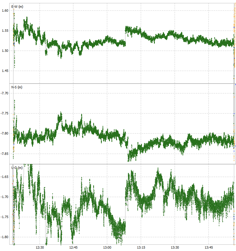

Facet returning inconsistent elevations
what the conditions might be that would give you that level of vertical accuracy.
In short, ideal and often in the laboratory. In the real world, I would expect double that or perhaps 30mm, but I agree with @rftop, 500mm is a lot. Do you have a 2nd RTK device that is capable of base mode? It would be interesting to see what a more localized base produces; yes the local base will be absolutely less accurate than the CORS station 38km away, but all you care about is proving whether the ZED is capable of outputting a less variable elevation when a base is nearer.
Yes this is a good idea. I have a second Facet that I bought to be able to use as a local base station for corrections but I moved on from that plan at some point. I have some old files from those tests, but I’ll also try to do some new tests with that setup later in the week. Thanks for the suggestion.
I have the impression from anecdata that ACORN does not lead to the same solution quality as MaCORS. MaCORS works amazingly well. I would suggest going to somplace in the MaCORS service area (so that you have stations in all directions and it can interpolate) and testing there. The MaCORS MSM4 iMAX mountpoint is the one I would recommend.
There is being in FIX, and then having lots of satellites. You need to wait to get more, and be in an open area, if you want the best vertical accuracy.
What you are reporting looks more like RTK Float behavior to me.

This is very useful to have some perspective on this. My most consistent results, i.e. this:
are from single-baseline solutions from the closest MACORS site to my location. I have had less success with the iMAX from MACORS, but I am not within the MACORS service area, but ~20 km outside of it, so I imagine that’s why.
That would make sense but the instrument is reporting RTK fix during these tests. I’m unsure exactly what information is going into that though, do you know if the instrument will report RTK fix when it is actually in RTK float sometimes?

iMAX is very complicated; AIUI it is a network solution, synthetic data for very near you, both base coords and the carrier phases. The point is that it can interpolate among stations to get closer to the iono/tropo delays for where you are, and thus take out the 1st-order spatial terms. When you are outside, I don’t know how this works, but it’s Leica so I’d expect reasonable. I am surprised iMAX is ever worse than single base. Note that with MaCORS there is one site in RI, at URI, and I do not know if it’s the same Leica equipment. MaCORS seems to be run to a very high technical standard, almost like it’s part of NGS, so I’d expect them to insist on 1st-class operations.
Looking at your data there’s a jump at about 19:23:30. One thing that can happen is the receiver declares that it has a fixed solution but has incorrectly resolved the integer ambiguities. Then later, it makes a new estimate of the ambiguities and transitions. I find that when it’s wrong, it’s often a meter off, very ish, and there is slow wander. When it’s right, there is so little wander that the dominant horizontal noise is my ability to hold the pole level.
You said you had two. Try them both. I have never heard of a hardware problem that causes this, but the more data the better. Using your own base should also work, assuming the base has a full horizon view, and the units are close.
I have data from both and have had the same problems. I was initially thinking it could be a hardware problem but I’m fairly sure I’ve eliminated that (unless they both have the same problem).
I don’t know if it’s worse. I’ve had problems connecting sometimes, but now that I look at some plots where I used iMAX from MaCORS, it actually looks better. Here are a couple measurements I did a few weeks back. Note that the vertical scale is 20 cm on these plots and most of the above plots have a vertical scale of 40 cm:
The URI site is Trimble, the only one in the network which is not Leica. I’ve been confused about this site and I should follow up with the network operators. You can’t find it as a mountpoint to connect directly, so I wonder if it’s still part of the network solution. The reason I started using ACORN is because the URI station is in that network and I can connect directly to it.
The new graph has a big jump at 1509, but it’s 8 cm. And, your V wander is within maybe 18 cm. Not great, but much better.
Fair enough if two of them behave this way; that argues strongly for “not HW”.
I would contact the URI folks directly, esp. given that you’re working with NOAA and are thus legit and not some random hobbyist :slight_smile: I would think that the Leica network software could take inputs from Trimble; it’s just carrier phase observables, but now I’ll really speculating.

I get the impression that the high variance plots that I showed earlier are actually in RTK float, as people suggested, even though the instrument is recording them as RTK fix. So I guess it’s important to just ensure that the vertical spread of the observations is within a reasonable range manually before accepting that it actually is an RTK fix. The same can be said about the first few minutes of these “good” plots where the variance is high to begin but then gets lower, all while the instrument records the data as RTK fix. I imagine most of you know this already, I appreciate the help getting there.
