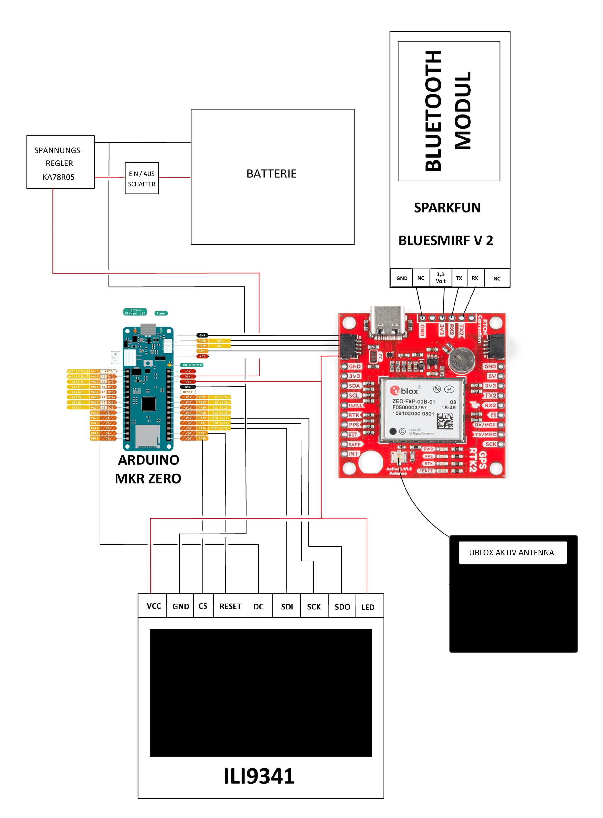

its to Ugly to make Portraits, ((o; But its exact like the Pinout / Schema Connected.
I Built 6 Devices, all with Mate Gold & Silver, since i use BlueSmiRF, the System is not longer working, possible to Build / Work Correct!

Above, you show the BlueSMiRF attached to 3.3V. Please try powering the BlueSMiRF with a 5V source. I believe we discovered on another post that the BlueSMiRF v2 may need 5V power in order to work correctly.
Hello Sparky,
Sparkfun 15136 connected via UART2 to BlueSMiRF v2 ist not ok? No 5V?
PAULZC : make it exact the same https://canada1.discourse-cdn.com/sparkfun/original/2X/9/93cfb2340df718b82f690766a9686e320acecfe7.jpeg
In your Hookup Guide its Written 3,3V -5V!
Hardware Overview - SparkFun BlueSMiRF v2 Hookup Guide
Or is this wrong?

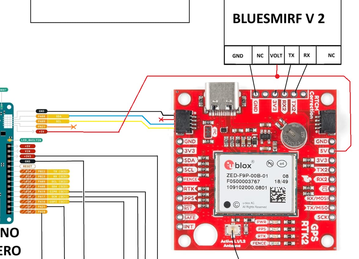

Looking at the MKR Zero, the 5-pin connector is outputting 5V not 3.3V:
If your schematic is correct, then it looks like you are feeding 5V from the MKR Zero into the ZED-F9P Qwiic connector?
The Qwiic connector expects 3.3V, not 5V. 5V will damage the ZED-F9P. You should be doing one of two things:
  • Feed 3.3V from the MKR Zero to the ZED-F9P and the BlueSMiRF v2,
  • Or, feed 5V from the MKR Zero to the 5V breakout pad on the ZED-F9P and the V pin on the BlueSMiRF. The BlueSMiRF V pin is 5V-tolerant.

The BlackBoard in the tutorial photo has a true Qwiic connector. It is 4-pin and outputs 3.3V.
The connector on the MKR Zero is 5-pin and outputs 5V power. The SDA and SCL signals are 3.3V.
You can do one of two things:
The second option is actually the best one. Then you are using the 5V->3.3V regulators on both the ZED-F9P board and the BlueSMiRF v2.

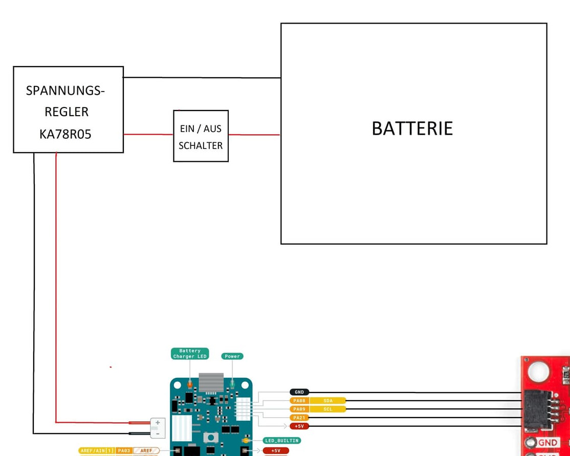

There may also be a problem with the way you are powering the MKR Zero, through the battery connector.
Looking at your schematic, you are feeding 5V from a 78R05 regulator into the MKR Zero battery connector:
Looking at the MKR Zero schematic, there seems to be no direct path from BATT+ back to +5V:
So, the 5V pin on the 5-pin connector may not be providing 5V at all. It looks like 5V is only available when VUSB or VIN are connected. Not when the board is powered only from the LiPo connector.

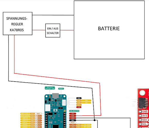

It would be better to power the MKR Zero through the VIN pad:
Yes sorry again, the Schema is wrong!
here the corrected version, like its really connected
I Power the MKR Zero also via VIN ! (o:
And now, Connect 15136 via MKR`s 3,3 Volt Connector
Aaaaaaaaaaaaaand HALLELUJA !!! with 3,3 Volt, the System works Perfekt!

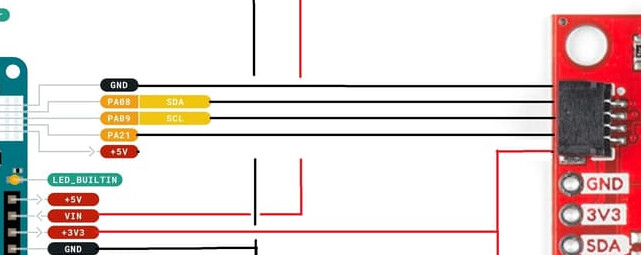

If you want your schematic to be truly accurate, I think you need to change the 5-pin connections - again:
I do not think PA21 is connected? I think you should remove that wire?
The Qwiic connector pins are:
  • From top to bottom:
  • GND
  • 3V3
  • SDA
  • SCL
Maybe you should move the 3V3 wire ‘up’, showing which pin it connects to?
Hello Paul,
Yes, P21 is Not Connected!
I must correct this also in the Schema… (o;
Thank you very much Paul!!
