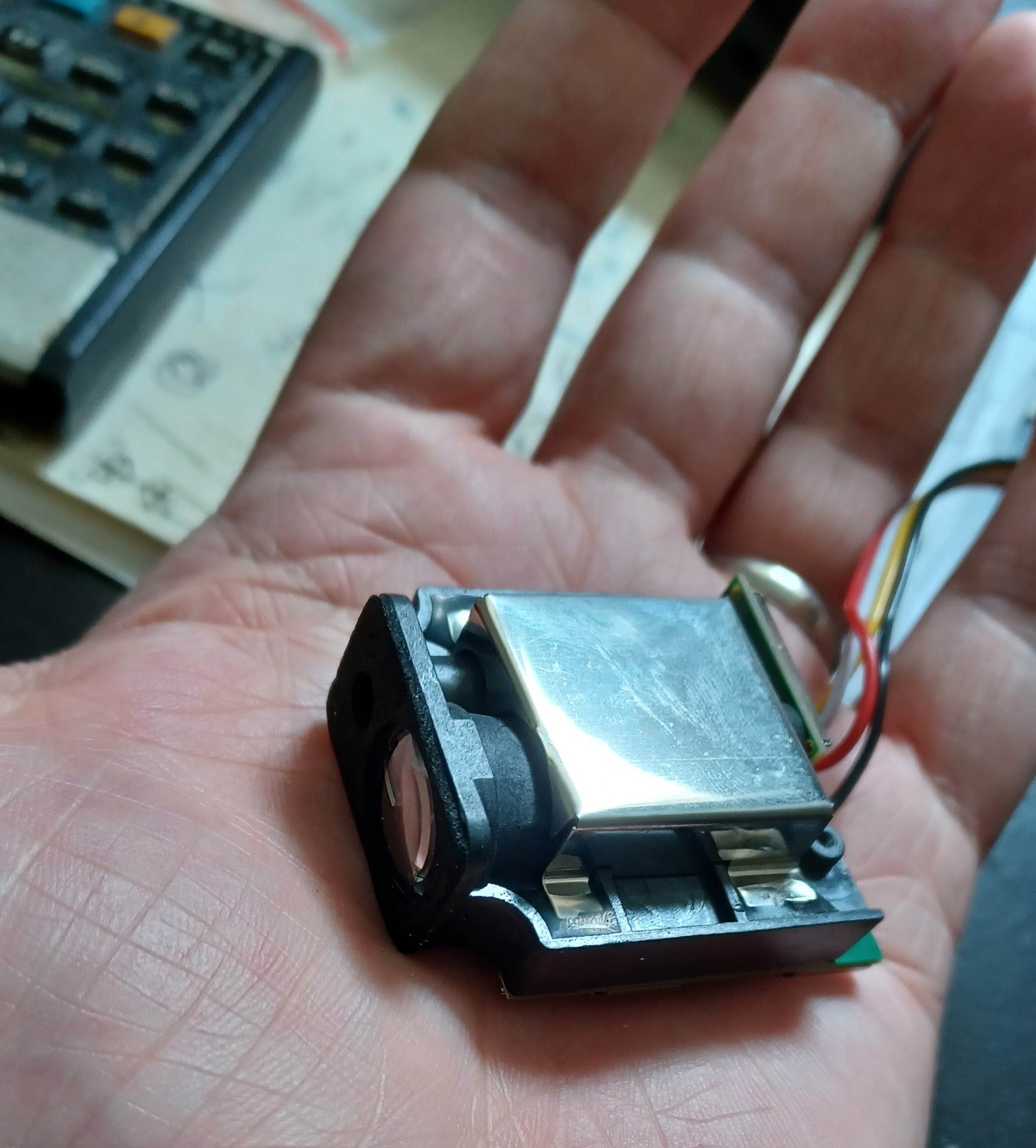

UPDATE: this device does have a name: DFRobot SEN0366 Laser Rangefinder
The above-referenced OEM distance measuring device claiming 80 m range does what I want under direct program control, via serial port. I just received one and it does show 20-point standard deviation varying between 0.2 and 0.7 mm in a data set of 4000 points, something I did not realize was available from this class of device at all. It appears able (with averaging) to repeatably resolve distance changes of less than 1.0 mm. Initial testing indicates the published specs are roughly correct, at least over short distances like 3 meters.
I find it unfortunate that the unmarked module seems to have no brand and no model number, so it cannot generally be referred to as a specific device. I’m not sure why that’s an advantage to whoever made it, but I suppose it must be. It runs on 3.3V and came already wired up to a separate USB-TTL interface stick marked “STC Auto Programmer” in a sort of kludgy way. Windows sees that as a CH340 USB-serial device. For best accuracy you have to use the slowest output, which for single commands takes about 0.75 sec per reading.
Sold on an auction site you probably know, under the heading “20hz High Accuracy 80m Laser Sensor Range Finder Distance Measuring Module TTL Interface Ardunio”
