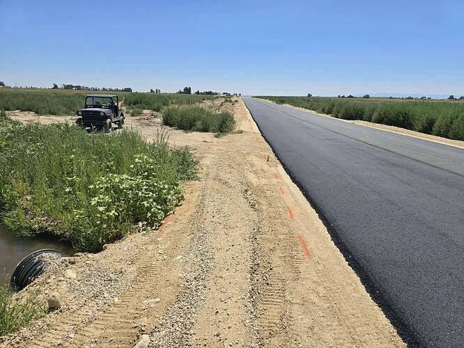

Pending official inspection by county officials, but every other layer has cleared. Despite the headaches, I know this road will last beyond what I would’ve contracted out. This road is within 1-2" in accuracy with the plans. I would say 1/2" but you couldn’t always trust the instruments on vertical height. On horizontal, it’s spot on, and you can see how straight it is with the Google Earth lines and satellite view.
The uncertainty of the vertical led me to make the 3/4" road mix layer from the called for 4" to 5-6" just to really make sure we don’t have any problems down the line. This 3/4" road mix could mean the difference between a 15 year and 30 year road.
AI helping with ongoing calculations + having this accuracy is great.
Also, RTK2go as a free service frequently had servers overloaded. I recommend if you’re a professional service, to figure out an alternate solution.
Maybe I’ll make a YouTube video. Maybe not. I just don’t think anyone is insane enough, has the time, and the amount of money to DIY.
The rest of my subdivision will be relying on the RTK devices despite the headaches. We are engineering 3D module to fit on top to minimize the stress on the antenna connector.

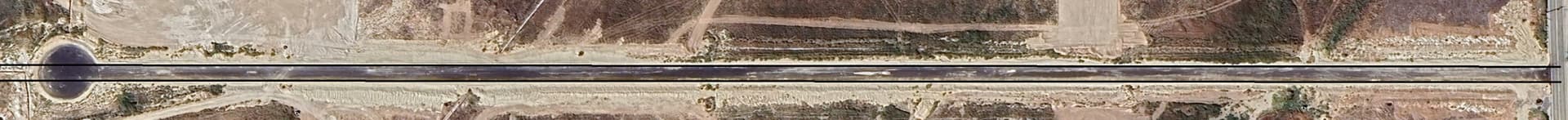

Satellite map just updated.
The two black lines were offset from the center property lines via KML, and using manual calculations and excel worksheets.
This level of accuracy was possible thanks to SparkFun RTK devices and our on-site SparkFun Reference Station routed through rtk2go.com
Despite the technical headaches, the results speak for themselves. Thank you SparkFun!
I managed this remotely using Discord, and RustDesk to remote into the Android devices with the “green dot” 1/2” accuracy of SW Maps.
