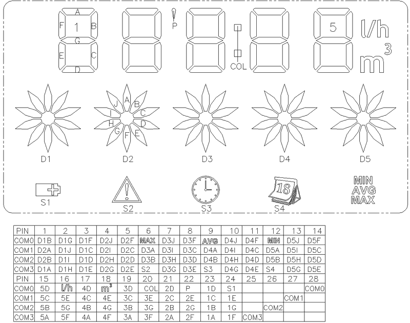

has anyone information about the SPK2 of the MSP430F413 Board from Olimex. :?:
This board has a new display and I’m looking for information about this LCD display
Can someone help??

The LCD Datasheet is available on the product’s description page.
[http://www.olimex.com/dev/images/LCD-413STK2-pinout.gif](http://www.olimex.com/dev/images/LCD-413STK2-pinout.gif)

Is this a static, 2-mux, 3-mux … type LCD display?
**Author:** ![rau-uv](https://avatars.discourse-cdn.com/v4/letter/r/74df32/32.png) [@rau-uv](https://community.sparkfun.com/u/rau-uv)\
**Post date:** [August 11, 2004, 5:23am UTC](https://community.sparkfun.com/t/olimex-msp430-413spk2-ldc-display/139/4 "2004-08-11T05:23:39Z")
It’s a 4 mux LCD
