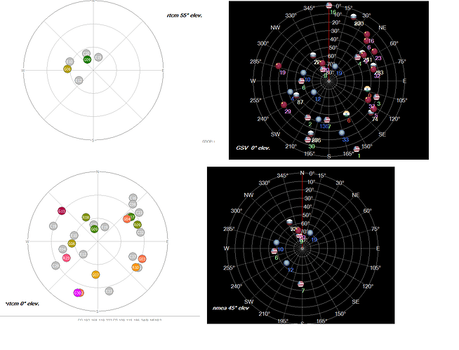

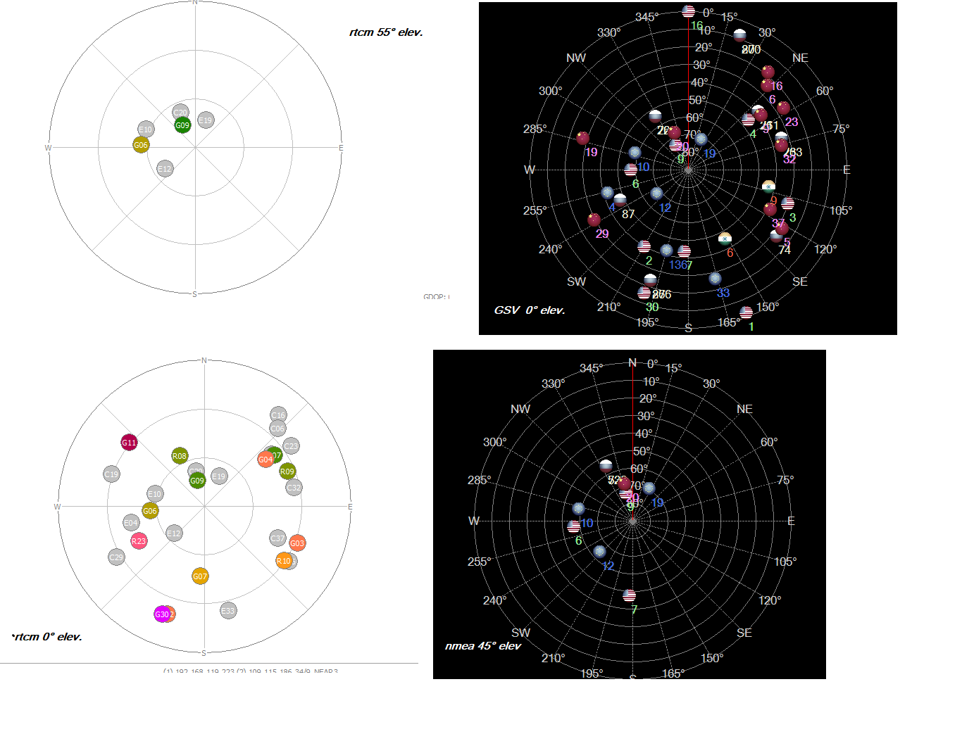

`minElev settings are two, one for `RTCM e.g. $PQTMCFGRTCM,W,7,0,55,07,06,2,1\*00
and other for NMEA output e.g. $PQTMCFGELETHD,W,45\*18 at the some time for the same setting:
I leaved the default rover\_mode and changed alternatively the PQTMCFGRTCM and the PQTMCFGELETHD; being in rover mode I enabled also all the rtcm’s then I could see them (rtcm) in rtklib on one panel and the nmeas (GSV) on another panel at the some time with the same but distinct configuration for both rtcm and nmea…
Imho better two separate settings because PQTMCFGRTCM affect only rtcm and PQTMCFGELETHD affect only nmea sentences; if possible also a setting for PQTMCFGCNRTHD.
