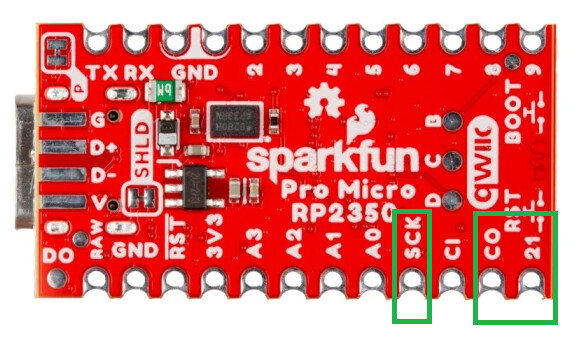

Looking for a pinout of the Pro Micro Rp2350 thats not the schematic, but looks like it doesnt exist?
I specifically need to know SPI pins to connect a Seeed 1.47 LCD and PWM capable pins.
DIN -?
CLK -?
CS -?
DC (any gpio)
RST (any gpio)
BL (any gpio)
**Author:** ![TS-Russell](https://yyz1.discourse-cdn.com/sparkfun/user_avatar/community.sparkfun.com/ts-russell/32/6092_2.png) [@TS-Russell](https://community.sparkfun.com/u/TS-Russell)\
**Post date:** [December 2, 2025, 7:36pm UTC](https://community.sparkfun.com/t/pro-micro-rp2350-pinout/67469/2 "2025-12-02T19:36:36Z")
There are a lot of naming variations for SPI ([see list @ bottom](https://en.wikipedia.org/wiki/Serial_Peripheral_Interface)), so the labeling doesn’t always match expectations, but they are labeled in [the schematic](https://cdn.sparkfun.com/assets/6/2/1/0/8/SparkFun_ProMicro_RP2350.pdf)
You need to use these 3 for the ? ones…CO is pico, 21 is CS, SCK is clock
 ![image](https://canada1.discourse-cdn.com/sparkfun/original/2X/4/48efb07650b220ee0409428f1921c387272f1281.jpeg)

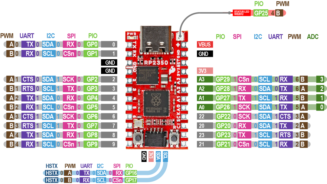

All GPIO on RP2350 are PWM-capable 🙂
**Author:** ![ponch0v](https://yyz1.discourse-cdn.com/sparkfun/user_avatar/community.sparkfun.com/ponch0v/32/10440_2.png) [@ponch0v](https://community.sparkfun.com/u/ponch0v)\
**Post date:** [December 17, 2025, 8:15pm UTC](https://community.sparkfun.com/t/pro-micro-rp2350-pinout/67469/5 "2025-12-17T20:15:05Z")
Working on creating an easier pinout diagram for this.
Can you verify this Russell? I went by section 1.2.3. GPIO Functions (Bank 0) in the datasheet but maybe there are some specific changes for the ProMicro?
 ![ProMicro_RP2350_Pinout](https://canada1.discourse-cdn.com/sparkfun/original/2X/c/c6de41dd505358bbb673a5b0cfd05b5c6a167170.png)
**Post date:** [December 18, 2025, 11:55pm UTC](https://community.sparkfun.com/t/pro-micro-rp2350-pinout/67469/6 "2025-12-18T23:55:54Z")
Looks accurate to me, except HSTX is not supported on our board (it is supported by the chip but not implemented in our design)
