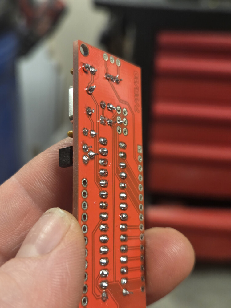

**Author:** ![emcm\_exhibits](https://avatars.discourse-cdn.com/v4/letter/e/45deac/32.png) [@emcm\_exhibits](https://community.sparkfun.com/u/emcm_exhibits)\
**Post date:** [January 7, 2026, 6:42pm UTC](https://community.sparkfun.com/t/programmer-is-not-responding-error/67258/26 "2026-01-07T18:42:25Z")
I finally desoldered the LCD board in order to look at the soldering points for all the pieces. Allegedly the connector is causing the issue, yet everything looks solid.
At this point, I’m tempted to say these are both duds 😓 I just have no idea.

**Author:** ![TS-Russell](https://yyz1.discourse-cdn.com/sparkfun/user_avatar/community.sparkfun.com/ts-russell/32/6092_2.png) [@TS-Russell](https://community.sparkfun.com/u/TS-Russell)\
**Post date:** [January 9, 2026, 1:12pm UTC](https://community.sparkfun.com/t/programmer-is-not-responding-error/67258/27 "2026-01-09T13:12:20Z")
Most of them look good, I’d just add some flux and then add more solder to the pins that don’t have a ‘hershey’s kiss’ style mound (80-90% look fine) and re-test
Also: is the FTDI in 5v or 3.3v mode?

My colleague asked what temp I had been using for soldering, and I was at 435 F because that’s just what the gun was set to. Looks like the melting point is 361 F. I didn’t hold the tip there for any more time than necessary. That difference wouldn’t be enough to damage these boards, would it? Overall they don’t look to have any burn marks and the components don’t look like they’re bulging. He also thought I might be holding the soldering tip too long on the chip’s legs that it overloaded it, but I didn’t think I had it on there long enough to overheat it.
**Post date:** [January 20, 2026, 12:21am UTC](https://community.sparkfun.com/t/programmer-is-not-responding-error/67258/38 "2026-01-20T00:21:28Z")
That shouldn’t be it, most of the solder joints look good temp-wise, though there are many that could benefit from added solder material (mainly about half of the non-main two rows…the central 2 rows look great except the last 2 on the serial-ended side)
We have an older guide with a bunch of tips & tricks [How to Solder: Through-Hole Soldering - SparkFun Learn](https://learn.sparkfun.com/tutorials/how-to-solder-through-hole-soldering)
