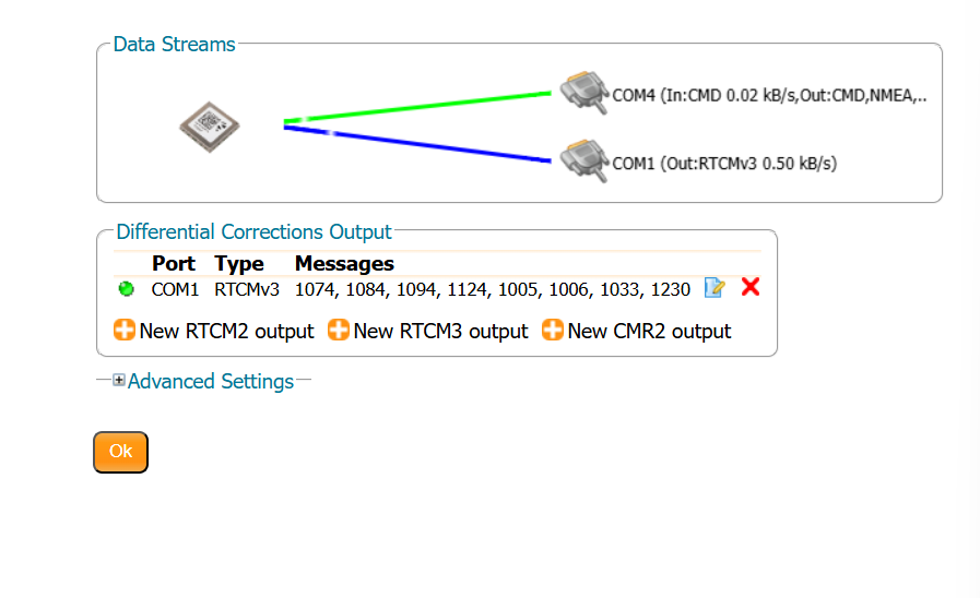

On the corrections output tab, I have COM1 outputting RTCMv3 info and the default selected messages being output. I have clicked ‘OK’ and it shows COM1 sending data.

I think you are probably having baud rate issues. The Holybro SiK radios default to 57600 baud. If you change both the mosaic-X5 COM1 and the ZED-F9R UART2 to 57600, does it start working?
The 131974 Skipped bytes on UART2 is a big clue. Data is being received, but the ZED cannot interpret it. When the link is working correctly, you should see the 5-RTCM3 message count increase steadily on UART2. Skipped bytes should be zero, or near zero, and not steadily increasing. You can make UBX-MON-COMMS periodic too using UBX-CFG-MSG and avoid having to click “Poll” repeatedly. The “age” of the messages (top right) should toggle between 0s and 1s when they are periodic. If the age keeps increasing second-per-second, they’re not periodic.
The mosaic-X5 is reporting zero position accuracy because it is in Static (Fixed Base) mode. The accuracy estimate is only meaningful in Rover mode.
