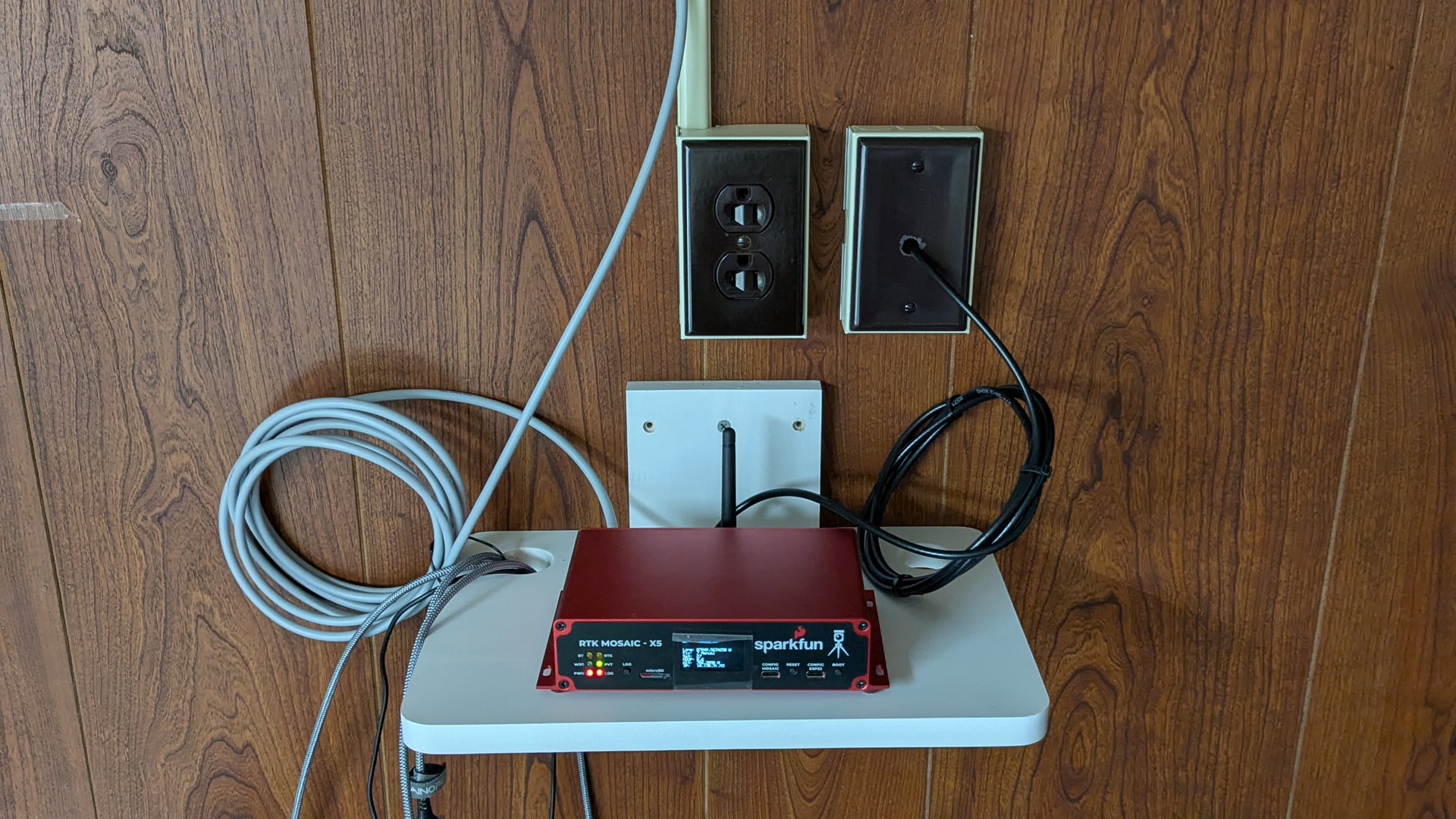

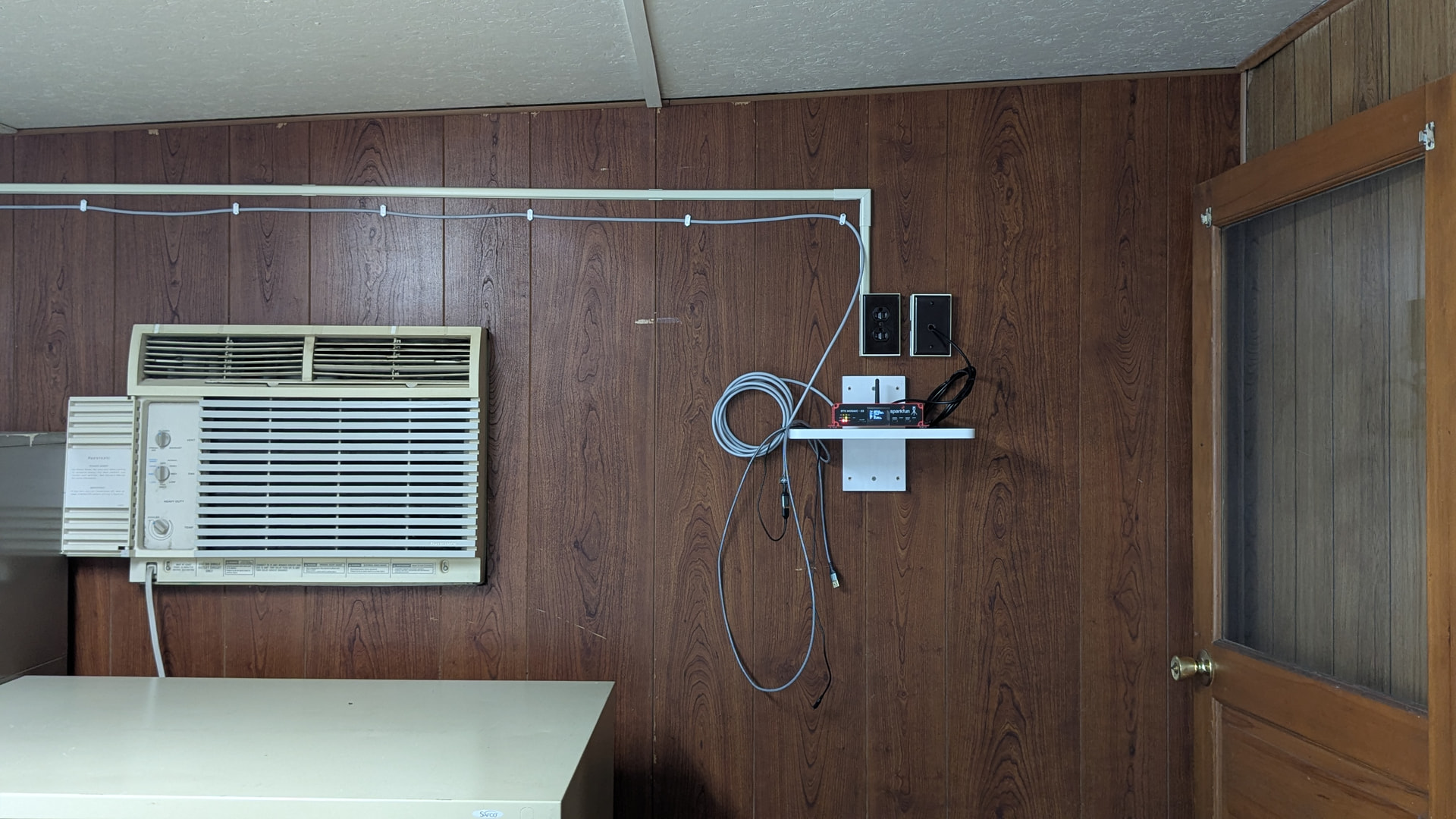

Paul,
```auto
      Thanks for replying. Nothing has changed with the X5 unit or its surroundings. The unit itself felt cool to the touch (though I hear the inside components are not thermally connected to the outer case). The unit is connected and also powered by Ethernet.
       I used the NTRIP stream extensively on Friday last week and it stayed operational all day. I rebooted the unit (power cycling it) Thursday around 4:30pm and it has been staying operational ever since. I was monitoring the Emlid Caster service page over the weekend to make sure the base unit was shown as "Online" and have been checking it this morning - so far so good. I just checked the "webpage" of the X5 now and was able to view it immediately.
       I will try to monitor the unit more closely for awhile, but I'm not sure whether to treat this as a fluke or what. Is there any diagnostic report I can provide you to review?
       Some photos of our unit and it's location:
 ![PXL_20251117_162342673](https://canada1.discourse-cdn.com/sparkfun/original/2X/0/02d5abb0079dfa6ad95089e658b3db72553ac357.jpeg)
 ![PXL_20251117_162326961](https://canada1.discourse-cdn.com/sparkfun/original/2X/5/55c162d885a33b599a4ba73c39d40439e6edab3b.jpeg)
Garry
**Author:** ![PaulZC](https://yyz1.discourse-cdn.com/sparkfun/user_avatar/community.sparkfun.com/paulzc/32/67_2.png) [@PaulZC](https://community.sparkfun.com/u/PaulZC)\
**Post date:** [November 17, 2025, 5:26pm UTC](https://community.sparkfun.com/t/rtk-mosaic-x5-unit-failing-after-24-hours-requires-reboots/67341/4 "2025-11-17T17:26:14Z")
Hi Garry (@gbunk ),
Thanks for the update.
Your setup looks perfectly fine. I’m hoping your outages were just a fluke.
Some users have reported that the X5 can misbehave if it gets too hot. But that seems unlikely with your setup. Those users had the units located in a server cabinet / loft space.
There have also been (I think) three reports of antenna failure, due to the active antenna power circuit _inside_ the X5 failing. At least one of those was due to lightning. We never fully understood how the others failed. You’re not seeing the same issue. When that failure occurs, it is permanent. Power cycling has no effect.
I’m clutching at straws here… But could it be a glitch from your air con unit, being picked up by the Ethernet cable? Maybe you have that unit turned off at this time of year though?
One thing you could try is to send your corrections to RTK2go at the same time as Emlid. RTK2go will give you an uptime since the last restart, which is a useful diagnostic.
 ![image](https://canada1.discourse-cdn.com/sparkfun/original/2X/0/07ddd1a5bb73067cace1dd0aa70ac0211e636c1f.png)
The X5 does have an internal logging system. On the X5 web page, the Admin tab \ Receiver Messages will show any recent events. The Admin tab \ About page has a link to the full Diagnostic Report. Scroll down to lstInternalFile, Error and lstInternalFile, rxMessages for the most relevant error reports.
