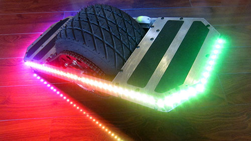

I put the finishing mechanical touches on the board this weekend. Now it’s just down to software.
The LED strip went on easy. There ended up being a total of 103 addressable LEDs on the strip.
Here’s a comparison of the two boards. The new one is definitely lighter and sleeker than the original.
The LED strip really adds some flair.
I tuned the balancing variables and it rides quite well. It’s definitely trickier to ride than the original, but much more maneuverable.
