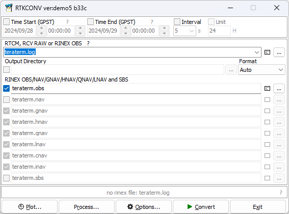

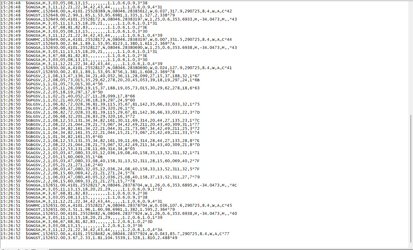

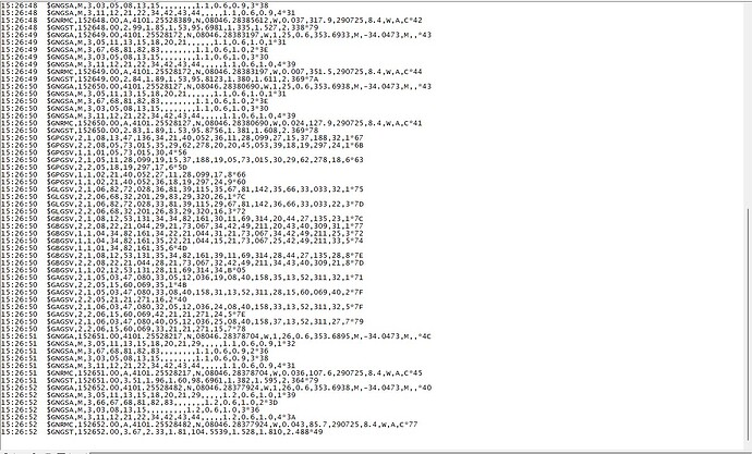

Hello everyone,
I’m trying to set the RTK Torch to log data in UBX format to send it later to OPUS and CSRS, however, after setting my messages I noticed there is no option to enable: UBX\_RXM\_RAWX or UBX\_RTCM\_1230 for example.
I used to do this using an RTK Facet head but its faulty now and we are currently waiting for the spares to repair it, my question is, is it possible to log data with the torch? I’m using SW Maps on an android tablet to log the data as the torch doesn’t have a SD card slot built in.
When I log data and try to convert to RINEX on emlid studio software it gave me an error, I reached emlid customer service and they said the UBX file I sent its binary but it contains the NMEA messages and that’s the reason I can’t convert to RINEX
Using U-Center I can see this:

**Author:** ![sparky](https://yyz1.discourse-cdn.com/sparkfun/user_avatar/community.sparkfun.com/sparky/32/6021_2.png) [@sparky](https://community.sparkfun.com/u/sparky)\
**Post date:** [July 29, 2025, 9:41pm UTC](https://community.sparkfun.com/t/setting-up-a-torch-unit-to-record-rawx-data/66256/6 "2025-07-29T21:41:43Z")
No luck yet, but the device is outputting the messages correctly AFAIK:
Rover Accuracy (m): 1.031, SIV: 31 GNSS State: 3D Fix
    rtkParse Unicore Binary, 0x0094 (148) bytes
    rtkParse NMEA GNGGA, 0x0058 (88) bytes
    rtkParse Unicore Binary, 0x0048 (72) bytes
    rtkParse RTCM 1019, 0x0043 (67) bytes
    rtkParse RTCM 1020, 0x0033 (51) bytes
    rtkParse RTCM 1042, 0x0046 (70) bytes
2025-07-29 21:39:06.026
    rtkParse RTCM 1046, 0x0045 (69) bytes
    rtkParse RTCM 1074, 0x00c5 (197) bytes
    rtkParse RTCM 1084, 0x0084 (132) bytes
    rtkParse RTCM 1094, 0x00d7 (215) bytes
    rtkParse RTCM 1124, 0x0143 (323) bytes
But RTKLIB RTKCONV is not happy with the log file, so far:

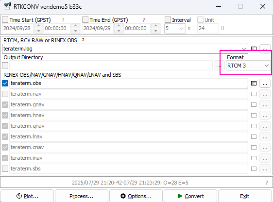

**Post date:** [July 29, 2025, 10:25pm UTC](https://community.sparkfun.com/t/setting-up-a-torch-unit-to-record-rawx-data/66256/9 "2025-07-29T22:25:41Z")
Paydirt! Per usual, _listen_ to Paul. I forgot to set the format to RTCM 3
 ![image](https://canada1.discourse-cdn.com/sparkfun/original/2X/4/4ff3558e60c7304042062d4bedadbe9f31680fe2.png)
![image](https://canada1.discourse-cdn.com/sparkfun/original/2X/b/b310046face25dee05d854399d14e2dd2f3bedd8.png)
Now I only logged for ~30 seconds but I think this works. I’ll start building out that logging option. It’s pretty tedious to select all the RTCM messages.

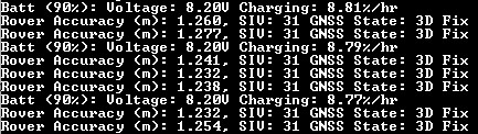

I just got this:
 ![Screenshot 2025-07-30 094228](https://canada1.discourse-cdn.com/sparkfun/original/2X/6/642821d0fc050c624467c352facfe8a6ea49818b.jpeg)
Of course the Output GNSS data to USB is disabled, but even when enabled i just see the whole strings.

**Author:** ![rftop](https://yyz1.discourse-cdn.com/sparkfun/user_avatar/community.sparkfun.com/rftop/32/6121_2.png) [@rftop](https://community.sparkfun.com/u/rftop)\
**Post date:** [July 31, 2025, 4:11pm UTC](https://community.sparkfun.com/t/setting-up-a-torch-unit-to-record-rawx-data/66256/13 "2025-07-31T16:11:40Z")
> [@Avantasian](#):
> How you got the data displayed like that?:
In the Serial Configuration, go to
s) Configure System
From there, you have several menus to play around in, like:
d) Debug software
h) Debug hardware
p) Configure periodic print messages
 ![image](https://canada1.discourse-cdn.com/sparkfun/original/2X/7/70435dfc6a803439cd5a34a6685c92a4606ebad8.png)
