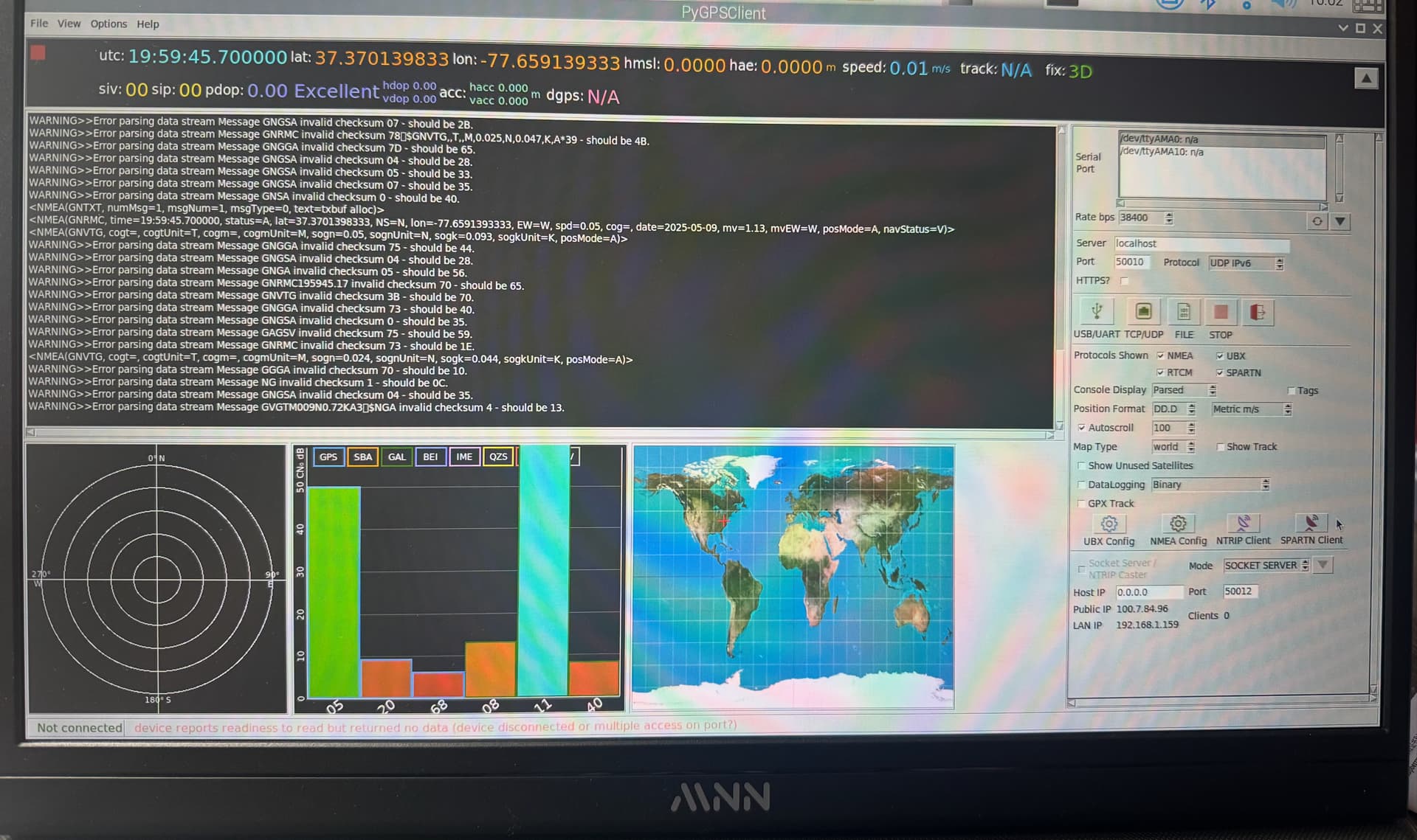

**Author:** ![nnkGoose](https://avatars.discourse-cdn.com/v4/letter/n/779978/32.png) [@nnkGoose](https://community.sparkfun.com/u/nnkGoose)\
**Post date:** [May 9, 2025, 8:08pm UTC](https://community.sparkfun.com/t/sparkfun-zed-f9r-gps-rtk-phat-coordinates-are-returned-as-null/64973/8 "2025-05-09T20:08:53Z")
Making some incremental progress with the PyGPSClient utility, which is exciting. Correct coordinates displaying in this utility though lots of error messages with invalid checksums as well. Still not able to programmatically fetch coordinates using the Spark Fun library.
