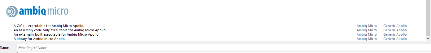

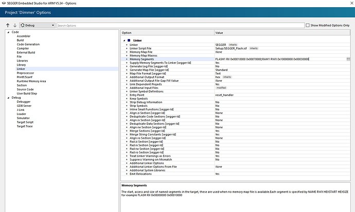

**Author:** ![marsfan](https://avatars.discourse-cdn.com/v4/letter/m/e47c2d/32.png) [@marsfan](https://community.sparkfun.com/u/marsfan)\
**Post date:** [January 6, 2021, 9:57pm UTC](https://community.sparkfun.com/t/success-using-segger-embedded-studio-with-artemis/38298/36 "2021-01-06T21:57:46Z")
Cool. Going to see what changed with V1.8.
What I mean is that now if you download the Ambiq support package with Segger’s Package Manager, when you create a new project they have special Ambiq templatess that don’t use the same method of configuring memory, as the _Memory Segments[\i] displays None[\i], and it uses a little bit different setup of the initial files, with the Apollo3 Vectors in a seperate file. Its probably useful, I will just need to play around a bit before I know for sure what it does._
 _See the attached images of the new Ambiq template options, extra config page during project creation and the file structure._
![File Structure.png](https://canada1.discourse-cdn.com/sparkfun/original/3X/6/e/6ee7b66689d7ce41741f960ba17f30f2e0ff543b.png)
 ![Setup Properties.png](https://canada1.discourse-cdn.com/sparkfun/original/3X/2/1/218948100b63352b0acb2504612d9c4cb81cb79b.png)
 ![New Options.png](https://canada1.discourse-cdn.com/sparkfun/original/3X/3/0/30d4ef35229e1ca1eff284c62aa23ed27bb4e1d4.png)

Hmm. Not all images attached.
 ![No Memory Segments.png](https://canada1.discourse-cdn.com/sparkfun/original/3X/e/1/e110dddce285d105aab3c74cbe9fe97a8bb0df6a.png)
**Author:** ![robin\_hodgson](https://yyz1.discourse-cdn.com/sparkfun/user_avatar/community.sparkfun.com/robin_hodgson/32/177_2.png) [@robin\_hodgson](https://community.sparkfun.com/u/robin_hodgson)\
**Post date:** [January 6, 2021, 10:10pm UTC](https://community.sparkfun.com/t/success-using-segger-embedded-studio-with-artemis/38298/38 "2021-01-06T22:10:02Z")
That probably makes sense because a generic Ambiq build would not know anything about a Sparkfun SVL bootloader. To support the SVL bootloader, just change your project/options/linker/memory segments as in the screenshot below for FLASH1. The RAM1 definition only matters for my project.
 ![mem-segments.jpg](https://canada1.discourse-cdn.com/sparkfun/original/3X/8/8/88a80456174491daa03ca49761d748b64e72dce5.jpeg)
**Post date:** [January 9, 2021, 2:08am UTC](https://community.sparkfun.com/t/success-using-segger-embedded-studio-with-artemis/38298/39 "2021-01-09T02:08:20Z")
Ok. So I tried using the Ambiq templates that Segger now has built in. They use a older version of the Ambiq CMSIS files than you can get through Sparkfun. The end result is that if you use it, you will need to do a lot of tweaking to the configuration files to get Sparkfun’s examples working, as they use defines that are not in the older CMSIS versions (related to IC revision checking).
However, there are a couple of notable differences that the Segger template provides from what Robin’s tutorial documents suggest. So far I have found:
- - The CMSIS Files are in a folder that SES creates in the project.
- - The Vector Interrupt Definitions are done in a seperate file. (\*apollo3\_vectors.s\*)
- - Additional IRQ vectors are defined at the end of the vector table. (The part with all of the \*.word\* stuff.
- - The empty set of points that for the bluetooth subsystem are not configured.
Does anyone know what the reasoning is for the last two bullet points? I have uploaded the startup files below for reference. (I had to change the extension, as the forum does not allow uploading files with the _.s_ extension.
