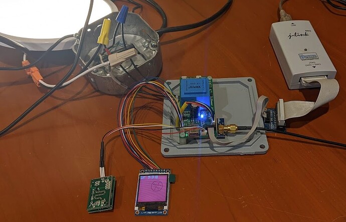

Here is the latest SES/Artemis project: a trailing-phase LED lighting dimmer.
