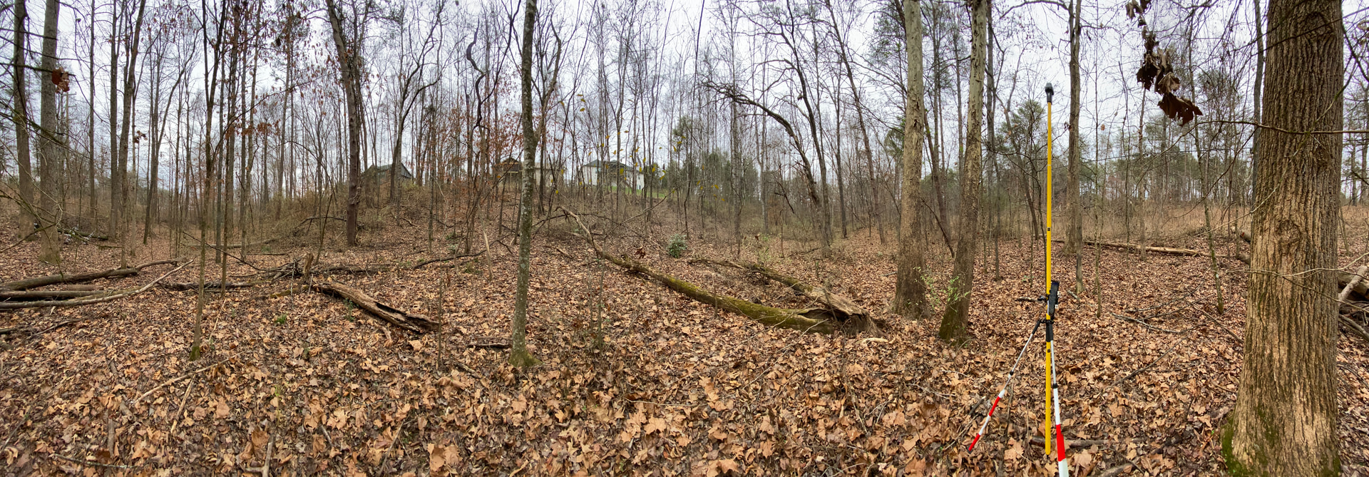

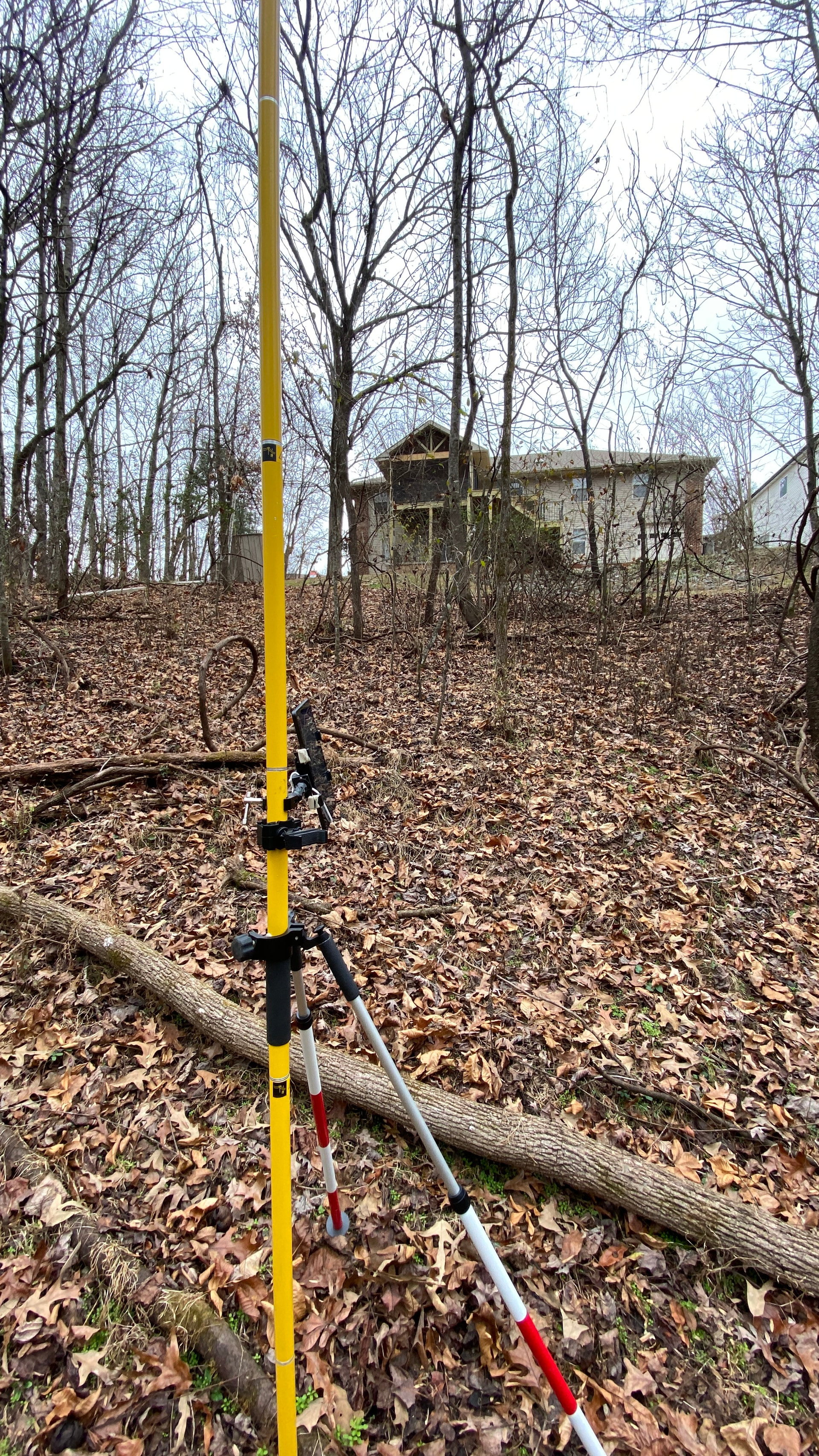

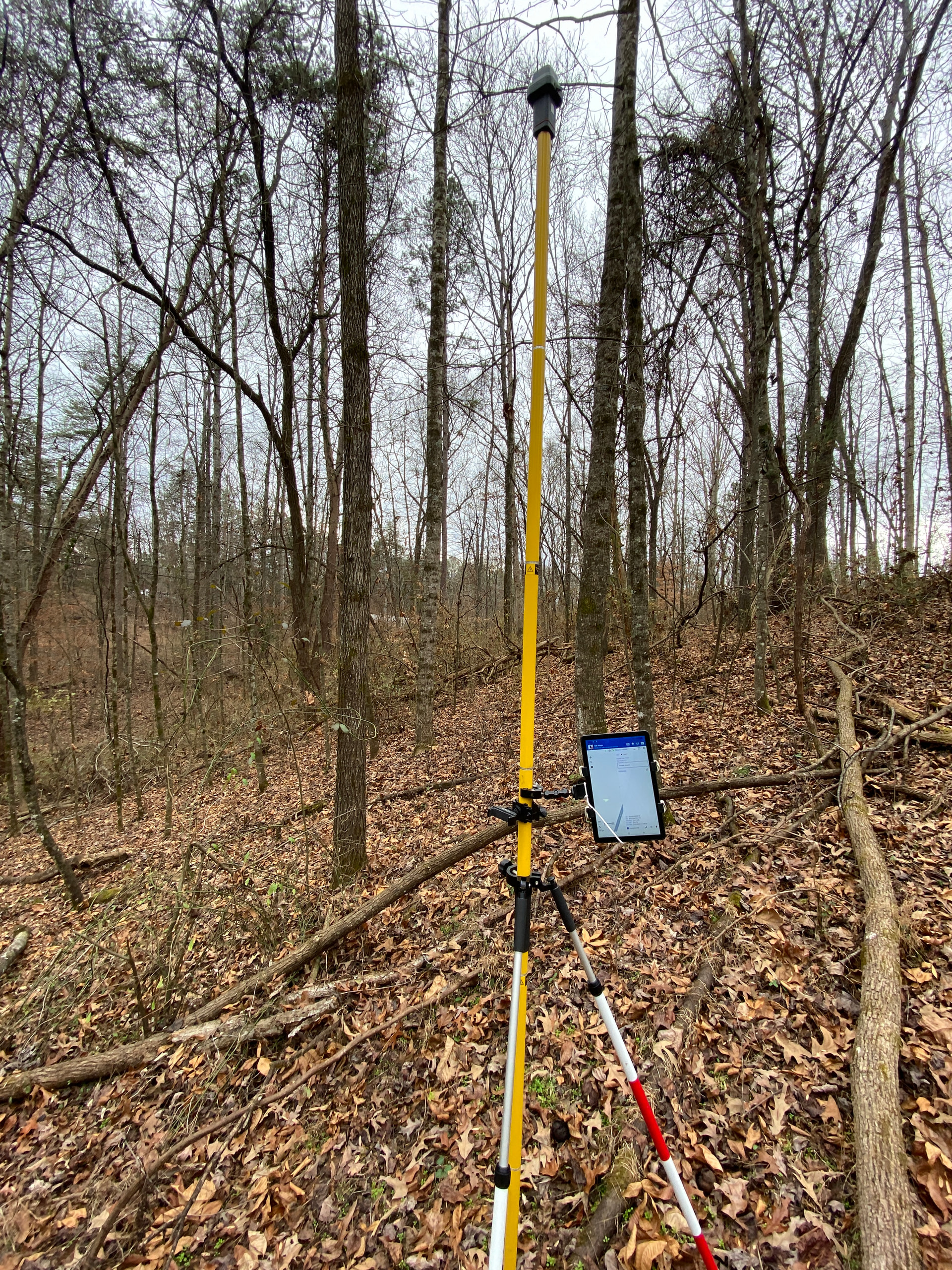

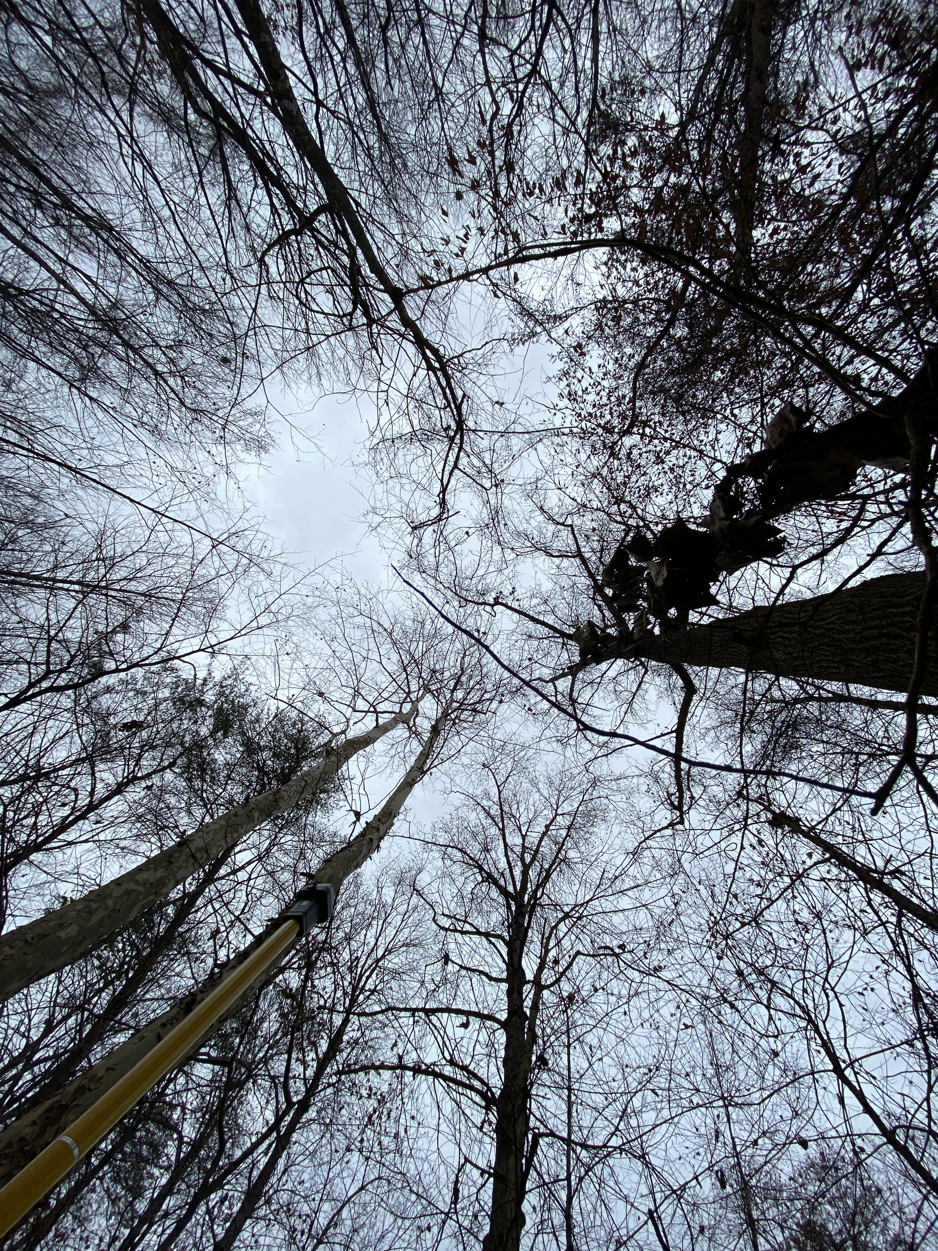

These are the Conditions, RKT FIX maintained perfectly even deep into the valley
64ft elevation change between my 154.9ft test bed, and the bottom of the valley in the woods behind the house. I don’t know why this Correction service would work so much better… but it definitely is…

Maybe I’m missing it, but I don’t see a bubble level on the rod ?
You should be able to get well under the reported **±3 cm** with the rod plumb and turn-off tilt compensation.
**Author:** ![ChrisO](https://yyz1.discourse-cdn.com/sparkfun/user_avatar/community.sparkfun.com/chriso/32/8607_2.png) [@ChrisO](https://community.sparkfun.com/u/ChrisO)\
**Post date:** [December 18, 2025, 8:46pm UTC](https://community.sparkfun.com/t/warning-ppl-is-offline-continuing-to-struggle-with-woods-and-rtk-torch-configuration/67025/29 "2025-12-18T20:46:47Z")
There is a bubble level just under the clamp for the legs. I have Tilt Compensation ON (in my past failures months ago I had Tilt comp OFF) however the Tilt compensation doesn’t appear to be working. If I radically tilt to move the head 2ft off point, SW MAPS reports I moved 2ft. The tip is still at exact same point. And Torch is set to reflect 3m pole…. but at this point, that is a really minor issue…. I am actually getting RTK FIX!!! FINALLY
**Post date:** [December 18, 2025, 9:07pm UTC](https://community.sparkfun.com/t/warning-ppl-is-offline-continuing-to-struggle-with-woods-and-rtk-torch-configuration/67025/30 "2025-12-18T21:07:01Z")
And I was actually pondering shortening up the Survyors pole it’s 3 meters, I may reduce to 2m as if I am off with my Bubble Level a hair it’s moving the torch a lot more 3meters up vs 2m up….

Saturday testing on the Farm/Woods went extremely well. I still occasionally lost RTK FIX, but was rare. I did notice I lost it in the PINE forests as needles were still on of course. Oak forest was bare of leaves, and never lost RTK Fix. I will continue to experiment in different valleys and different densities of woods but this is very promising. My test area is fairly flat so perhaps the easiest farm/woods location
**Post date:** [December 24, 2025, 1:35am UTC](https://community.sparkfun.com/t/warning-ppl-is-offline-continuing-to-struggle-with-woods-and-rtk-torch-configuration/67025/38 "2025-12-24T01:35:34Z")
Day 2 of testing went better than the first. I didn’t work as long, but in some deeper pine tree area’s I kept signal the entire time today. I didn’t change any settings from Saturday’s session. Satellite Elevation is still 15 and Signal/Noise is still 30

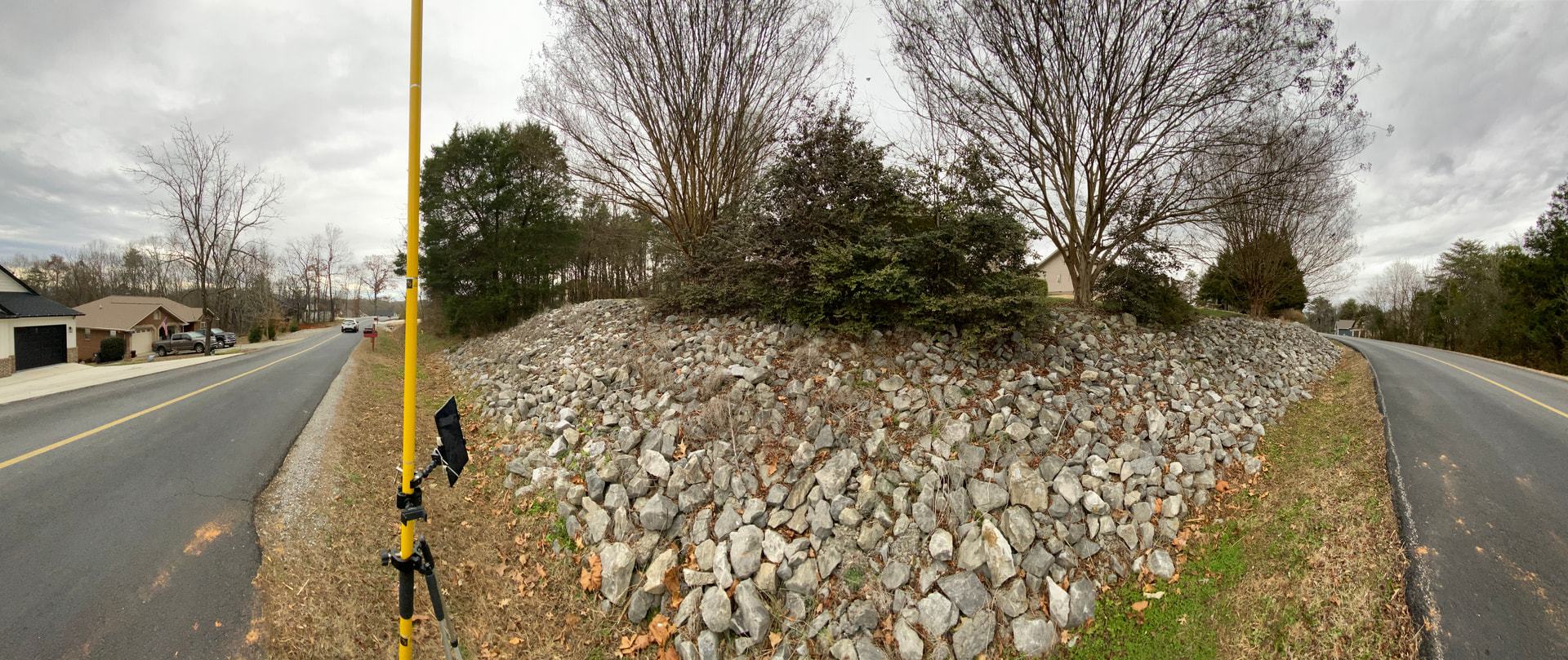

**Post date:** [January 3, 2026, 2:45pm UTC](https://community.sparkfun.com/t/warning-ppl-is-offline-continuing-to-struggle-with-woods-and-rtk-torch-configuration/67025/39 "2026-01-03T14:45:59Z")
I now have about 6 days of about 2 to 5 hours each day of testing under my belt.
I keep heading into deeper valleys and deeper woods. I finally got the PointPerfect FLEX RTCM/NTRIP to drop out of RTK FIX into RTK FLOAT and even after waiting 15 minutes it did not go back to RTK FIX. I was up against a Cedar Tree (a Pine that keeps Needles on and is dense cover), that was surrounded by other Cedar Trees, and I couldn’t even see the sky. As soon as I stepped 30ft away into a small clearing RTK Fix was back in 2-3 minutes, but would disappear immediately after I stepped back into the Cedars. Other than that FLEXT RTCM has continued to be amazing improvement over legacy PointPerfect MQTT. My next test in a week or two (after Deer season ends) is to try it in some of my deeper valleys that are all Oak (no leaves or needles like on the Cedars) I think after the deep valley and big oak tests we can unequivocally say stop using MQTTT and pay the extra ($8 vs $15 a month) for FLEX RTCM/NTRIP. I cannot compare this to Free NTRIP from various states, or [RTK2GO.com](http://RTK2GO.com) website as there are no services close to my farm….. Final update for this thread by end of January 2026 HAPPY NEW YEAR!!!
Everywhere v 2.2
TCL Android Tablet with SW Maps latest version
iPhone 11 as Hotspot for SparkFun RTK Torch
6ft surveyors pole with tripod legs added
