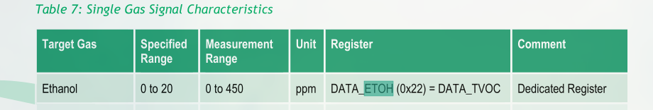

Air Quality Sensor ENS160 with equal values for TVOC and ETOH
I use the Indoor Air Quality Sensor (ENS160, SEN-20844) and some other sensors connected to the DataLogger IoT (DEV-22462, firmware 01.02.00) via Qwiic. When reading the air quality parameters, the values for ENS160.TVOC and for ENS160.ETOH are always identical. Eg. (Column 7 and 8 are identical):

Is this a bug? And if it is, is there a workaround to read the correct values of both parameters?

I’m guessing there’s a typo in the library; create an issue here Issues · sparkfun/SparkFun_Indoor_Air_Quality_Sensor-ENS160_Arduino_Library · GitHub
I’m copy/pasting from the issue in Github, because I know that’s a little inconvenient for some.
Unfortunately there’s nothing wrong with the library. According to the datasheet the ETOH values are just the TVOC values, because the TVOC values are calibrated for ethanol! You can see that here:
“Virtual Mirror of the ethanol-calibrated DATA_TVOC Register”
…and again here “DATA_ETOH (0x22) = DATA_TVOC”
I also left notes within the library noting that the values share the same register. They are in fact the same…
#define SFE_ENS160_DATA_TVOC 0x22
// TVOC Data - shares register with ethanol data
typedef struct
    uint8_t tvoc_msb : 8;
    uint8_t tvoc_lsb : 8;
} sfe_ens160_data_tvoc_t;
#define SFE_ENS160_DATA_ETOH 0x22
// Ethanol Data - shares register with TVOC data
typedef struct
    uint8_t etoh_msb : 8;
    uint8_t etoh_lsb : 8;
} sfe_ens160_data_etho_t;
Hope this helps.

thank you for this information!!! Yes, it helps to sleep well again:-)! I had never thought of anything like that, even though I had actually taken a look at the ENS160 data sheet (but obviously I didn’t read it carefully enough).
