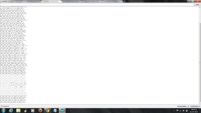

I managed to connect the atomic IMU 6DOF to the mega and used the code(given below) to read the data. I am getting a set of distinct numbers that actually make no sense at all…

Can you post the raw data and what you were doing to the IMU as that data was taken ? What portions of the data looked bad, the accel or the gyro outputs … or both ? Are you able to check that your serial link, Arduino-6DOF, is good ? That is your not getting framing errors or overun or parity errors or ???
Hey, here’s what you asked for, my above posted code generates this-
http://i821.photobucket.com/albums/zz13 … Output.jpg
Cheers!
How does the Arduino serial read function handle overruns and framing errors ? My first guess is that the data may be coming from the IMU faster than the Arduino can read it. I know the IMU has to spit out 3 accels and 3 gyros, what are the other 3 words supposed to be ?
EDIT : I did a quick look at the datasheet and comments and I found the output frame is supposed to be an ASCII “A”, sample count (since turn on I guess), 3 accels, 3 gyros and an ASCII “Z”. I’d assume that the default condition is auto-run but I have no idea of the default sampling rate. Perhaps you could ask SF what this is. Hopefully it’s slow enough to allow your loop to read in and complete the “print” out the data frame before the next frame. So my first inclination is to flush the buffer from the IMU and then check to see if data is “available”. When it is, do a character by character read (2 bytes) until the software detects an ASCII “A”. Then enter your loop reading 9 (8 more for the 1’st pass) byte pairs and “print” those out. I’m not sure if your loop needs to check to see if there’s a byte “available” each time before reading, I don’t know enough about Arduino sketch-speak to say. Ideally you should end up with an ordered output that we humans can more easily understand. Alternately if your software never “sees” an ASCII “A” (or data never becomes “available”) then it should time out (every few seconds seems reasonable) and “print” some error statement. I’d still enquire as to how an Arduino detects the aforementioned common serial errors and see if you can’t arrange some error printout for those as well.
I note that “count” comes appears to come across in binary format (0-32767 in 16 bits), so you may want to convert that to ASCII someplace after it’s read in and before it’s “printed” out. This will mean your output frame is longer than the input frame (assuming all output is all ASCII encoded) and thus needs more time to be transmitted. My SWAG at timing indicates so long as the IMU sampling rate is <100 Hz, you should be free from input overruns for a properly configured serial port (IMU<->Arduino), but the exact number will depend on how tightly the code can be done.

OK, I believe I see a few problems. Let me start with explaining what you probably already know. In binary output mode the data comes in “bursts” at the sampling frequency. Each burst consists of :
  • a leading ASCII “A”, one byte, value = 65d, 41h, 0100 0001b (that’s decimal, hex and binary representations)
  • 2 bytes of unsigned integer for the count, value = from 0 to 32767d (7F,FF h in MSB then LSB order)
  • 2 bytes of unsigned integer for the X accel, value = from 0 to 1023d (03, FF h in MSB then LSB order)
  • 2 bytes of unsigned integer for the Y accel, value = from 0 to 1023d (03, FF h in MSB then LSB order)
  • 2 bytes of unsigned integer for the Z accel, value = from 0 to 1023d (03, FF h in MSB then LSB order)
  • 2 bytes of unsigned integer for the pitch gyro, value = from 0 to 1023d (03, FF h in MSB then LSB order)
  • 2 bytes of unsigned integer for the yaw gyro, value = from 0 to 1023d (03, FF h in MSB then LSB order)
  • 2 bytes of unsigned integer for the roll gyro, value = from 0 to 1023d (03, FF h in MSB then LSB order)
  • a trailing ASCII “Z”, one byte, value = 90d, 5Ah, 0101 1010b
… for a total of 16 bytes per burst.
First problem is that you do this …
int imuData[9];
void setup() {
  Serial.println("#");
  Serial.println("-");
void loop() {
  for(int i=0; i<9; i++) {
    imuData[i]=Serial.read();
    Serial.print(imuData[i]);
    Serial.print("__");
… which treats each incoming byte as a signed 2 byte integer. I think (because I don’t speak Arduino sketch language) you need to declare imuData() as an unsigned integer and then you need to combine the bytes just read in before storing them in imuData(). This gets the binary data, which was split into bytes to be transmitted to the Arduino, back into it’s proper form. Obviously the single byte characters “A” and “Z” don’t get this treatment.
Problem #2 : that should be serial1.read
Problem #3 : you need to setup the serial port (0) to/from the PC at the Arduino end
? Problem #4 ? : why are you sending a space to the IMU after starting it ? Is that required ? I don’t think so. I read that it would stop the IMU (so I got rid of it below).
So what to do ? Read the IMU data in as bytes because that’s all you can do (I think), store them that way. Combine them (where required) and store them as imuData() because later in “life” you’ll want those 2 byte values to run your autopilot. Then just for debug purposes, print everything out as ASCII characters via the serial port to the PC where you can look at them and marvel at their goodness.
