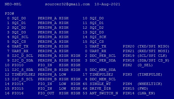

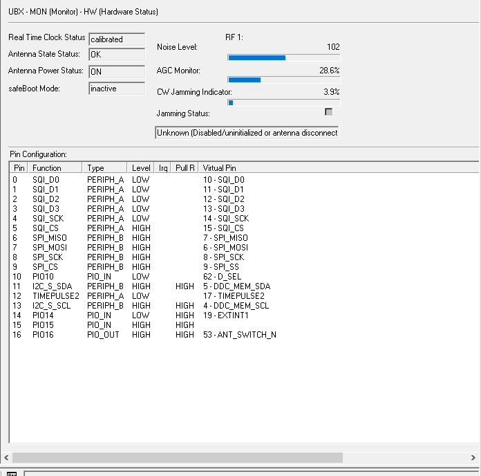

I found the same note in the Integration Guide. I spent some time in u-center playing with the different power management EXTINT pin assignments, on the theory that maybe the pin was assigned to power management functionality and that was blocking the time pulse capability. This is the pin mapping.
No amount of playing with settings seems to make a difference and, as far as I can tell, the pin mappings are read only. I did confirm that tying the INT pin high or low is reflected in the HW status message, so the pin works at that level.

It’s on EXTINT1, not EXTINT0, and TIMEPULSE is on TIMEPULSE2/SAFEBOOT from the IC, but I think wired to the normal pin on the NEO. The Sensor (IMU) has it’s I2C on TIMEPULSE1/EXTINT0, but I think that’s masked by the firmware.
I’d anticipate that it can use a TIMEMARK/EVENTIN, although these might associate with WHEELTICK/DIRECTION PIO, the NEO-M8L data really doesn’t talk about TIMEMARK

The M8L doesn’t do TIMEMARK as the extin pin is assigned to wheel pulse instead.

Details on TIMEMARK/EXTINT1 are scant in the M8U docs. The UBX-MON-HW is definitely promising as it shows associativity of the pin to the function. I’ll have to see if I can find an EVK and loop the TP/TM pins.
