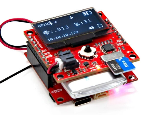

So, with the helpful suggestions here, I ordered a pair of Postcards, Portability Shields (even though not strictly necessary), and antenna-to-device cables (I already had the antennas), along with the LoRa Serial Kit to link them as a simple alternative to passing the correction data over the Internet.
After looking through what arrived in the mail today, I realized that the Portability Shield does not include the battery intended to fit between the two boards, or the headers to connect the boards. The receptionist at SparkFun suggested I reach out to the community to determine which products to purchase to round this equipment out. There are several batteries listed on the site but I’m not sure which one is intended to fit between the boards. Having not soldered components together before, I am equally unsure what header components I need. Based on the “Recommended Products” that are listed with the Portability Shield, I came up with the following:
Is this the best choice for battery: Lithium Ion Battery - 850mAh - SparkFun Electronics
Is this the needed header component: Break Away Headers - Straight - SparkFun Electronics
Is there anything else needed to complete this kit?
What about if I acquire a printed case for the boards? Is there anything else that I need in anticipation of that?
Thanks so much.
The Postcard with display on my desk is using ~200mA with an active antenna attached. So the 850mA will give you a few hours of run time. The 1250mAh a little more, but it does stick out a bit as shown is the pictures. You can always use an external battery bank if you need more.
Yep - those headers are what you need. That should be all you need.
A 3D printed case is left up to the end user because we don’t know what holes you need access to and the configuration you plan on using. Other users may have a good source or guidance on what worked for them.
I have the Postcard with its portability shield and a 5000 mAh battery.
It lasts me a full day of work and has never run out completely. I recharge it to 30%.
3D printing is up to you. There should be someone in your area who works in 3D, and using the example on the Sparkfun website, you can make modifications to fit a larger battery.
