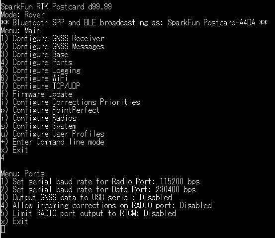

@TCIII : there is another setting which will help:
On the LG290P, from firmware version v04, it is possible to set different message rates on different ports. (That wasn’t true with the original v03 firmware.)
We added a setting which allows you to selectively disable NMEA on UART3 - the “Radio” port. You will find it in the Ports Menu. With v2.2 firmware, it appears as “5) NMEA output on radio UART3”:
In the more recent Release Candidate firmware, it appears as “5) Limit RADIO port output to RTCM”:
On 2.2, it defaults to: “5) NMEA output on radio UART3: Enabled”. On the RC, it defaults to: “5) Limit RADIO port output to RTCM: Disabled”. The setting is actually the same, it is just the wording that is inverted.

I disabled NMEA output on radio UART3 and still no RTK Fix.
On the other hand, the ZED-F9P on the Rover is still able to achieve RTK Fix at 57600 baud with the NMEA messages disabled on the RTK Postcard Radio port.
As for the LG290P on the Rover, is there a QGNSS command to make sure that the Radio port is enabled to allow incoming corrections or would I even be getting RTK Float if it was not enabled?

Thanks for trying that @TCIII ,
Shame it’s not the magic wand I was hoping for.
It is possible to disable the RTCM protocol on UART3. But, indeed, you wouldn’t get RTK Float if it were disabled. $PQTMCFGPROT,R,1,3* would confirm. 00000005,00000005 indicates all is well on v05. On v06, you should see 00000007,00000007.

I was able to borrow a L1/L2/L5 active antenna and that along with disabling the NMEA messages in the UART3 Radio output got the Rover LG290P to display a solid white RTK LED indicating a RTK Fix solution.
Thanks for all of your assistance and help Gentlemen!
