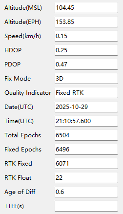

I am beginning to think that I may have a defective Sparkfun LG290P RTK GNSS Breakout Board (I received it second hand) as I get the following from the QGNSS Data View when the RTK LED and the PPS LED are flashing:
Fix Mode is blank whereas it should say 3D
Quality Indicator shows DGNSS where as it should say Float RTK
Total Epochs and Fixed Epochs are showing increasing five digit numbers
RTK Fixed is 0 as it should be
RTK Float is 0 where as it should be some numerical value other than 0.
If I unhook the Telemetry Radio input to the Radio connector on the Breakout Board the RTK LED quits flashing but the PPS LED keeps flashing.
If I keep the Telemetry Radio input hooked up, but detach the active L1/L2 antenna, the RTK LED keeps flashing, the PPS LED keeps on flashing, but most of the Data View indicators go blank except for Date, Time, Total Epochs and Fixed Epochs.

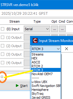

use strsvr for debug rtcm stream at the end of radio_link.
