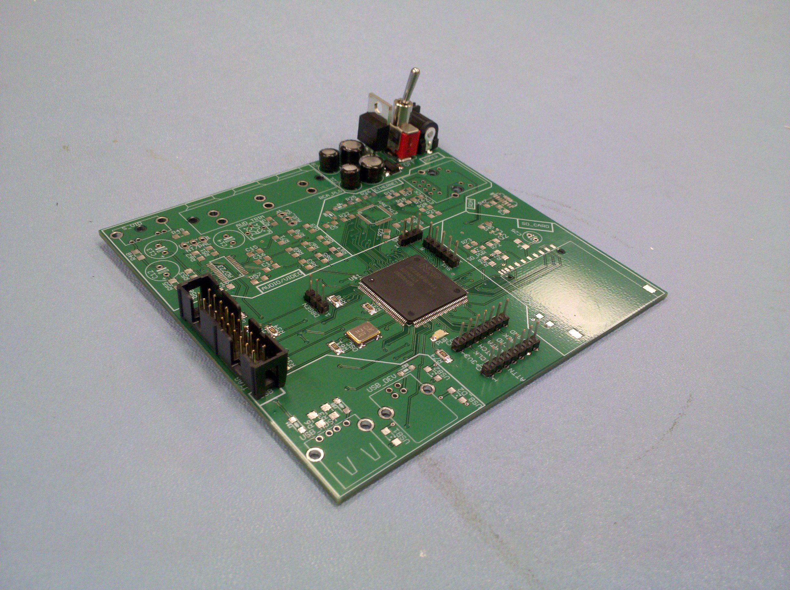

So I know coming to this segment of the forum with a fresh topic and a nightmarish topic like “custom board” is bad form, but I could use some help just verifying a few things to make sure I didn’t do this completely wrong.
Things about my setup:
  1. I’m working on a linux box, on a custom LPC2388 board of my own design, I can give plenty of details if needed, just ask and ye shall get snippets of the schematic! [Here is a quick picture of what currently assembled if you want to get an idea of what I’m working on.

The Problem:
So I start up openocd and get the following:
Open On-Chip Debugger 0.4.0 (2010-05-28-21:00)
Licensed under GNU GPL v2
For bug reports, read
	http://openocd.berlios.de/doc/doxygen/bugs.html
jtag_nsrst_delay: 200
jtag_ntrst_delay: 200
trst_and_srst srst_pulls_trst srst_gates_jtag trst_push_pull srst_open_drain
500 kHz
Info : clock speed 500 kHz
Info : JTAG tap: lpc2388.cpu tap/device found: 0x4f1f0f0f (mfg: 0x787, part: 0xf1f0, ver: 0x4)
Info : Embedded ICE version 7
Error: EmbeddedICE v7 handling might be broken
Info : lpc2388.cpu: hardware has 2 breakpoint/watchpoint units
Which looks correct to me, except the “Error: EmbeddedICE v7 handling might be broken” Should I be concerned about that?
I then connect using telnet, run “soft_reset_halt” and upload my code using “flash write_image main.elf” and try to run the code by telling it to continue from address 0. It seems to get into the bootloader or something, gets stuck in THUMB mode, and never exits. I’ve also gone ahead and tried to unplug my jtag programmer and disable the debugging to see if the code runs properly after that, but the LED never lights up like I keep hoping it will.
This is my first ARM project, so I’m not too sure how to proceed from here, I think I’ve figured out a lot of it on my own, but I’m not sure if I’ve done any of it properly. Any help would be greatly appreciated! Thank you for taking the time to read all of this!
