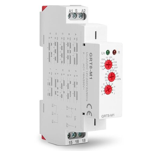

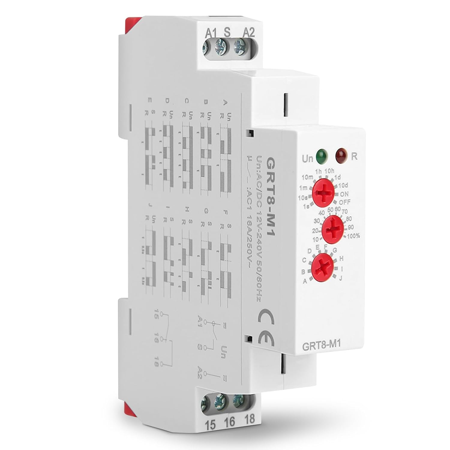

Solution:
Ready made timer controller
Here’s a compact little one but there’s all sorts with displays and multiple outputs
https://www.automationdirect.com/adc/shopping/catalog/relays_-z-_timers/timer_relays/t2r-m3-adj-240u

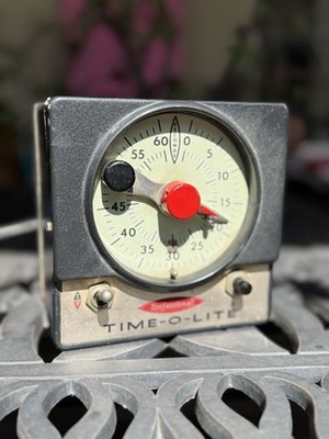

Years ago, big clockface timers were common for photography developing so there’s tons of that sort of thing to be found.

A time delay relay, a power supply, a button and your LEDs could work too. More expensive but might be easier for you to assemble.
