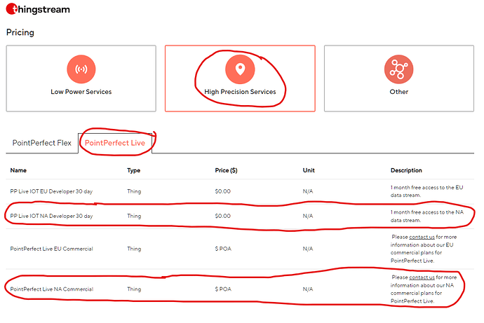

I am completely ignorant of the service and there appears to be multiple options related to PointPerfect. Is this the service that you are suggesting, that also appears to be free for low volume use:
I find this all rather confusing and need to narrow things down so that I can try to get my head around it.
Also, when I look at their coverage map, it appears to show the entire county covered with reference station availability. How is that possible? No mater how far I zoom into the map, it appears to show 100% complete coverage. I’m clearly missing something here.
The developer plan for testing various devices with the PP Service (as a product integrator).

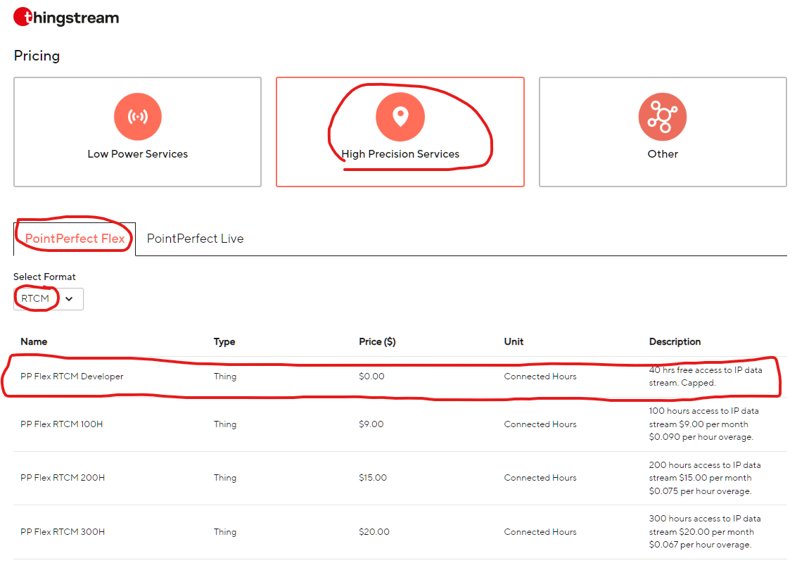

Since we are on the SparkFun Forum, I’d recommend purchasing the PP Flex RTCM plan through Sparkfun
This was the previous link to register for the older IP service:
I’m not sure how SparkFun handles purchasing a PP Flex (RTCM) account. Someone will hopefully chime in… or we can tag @sparky
You want:
Type = PointPerfect Flex
Format = RTCM for NTRIP delivery
I assume you will receive NTRIP credentials (User/password) that you enter into your data collector app (SW Maps, etc). Otherwise, you can also enter those credentials in the Torch Config, but I find it easier to let the App manage the NTRIP connection.
