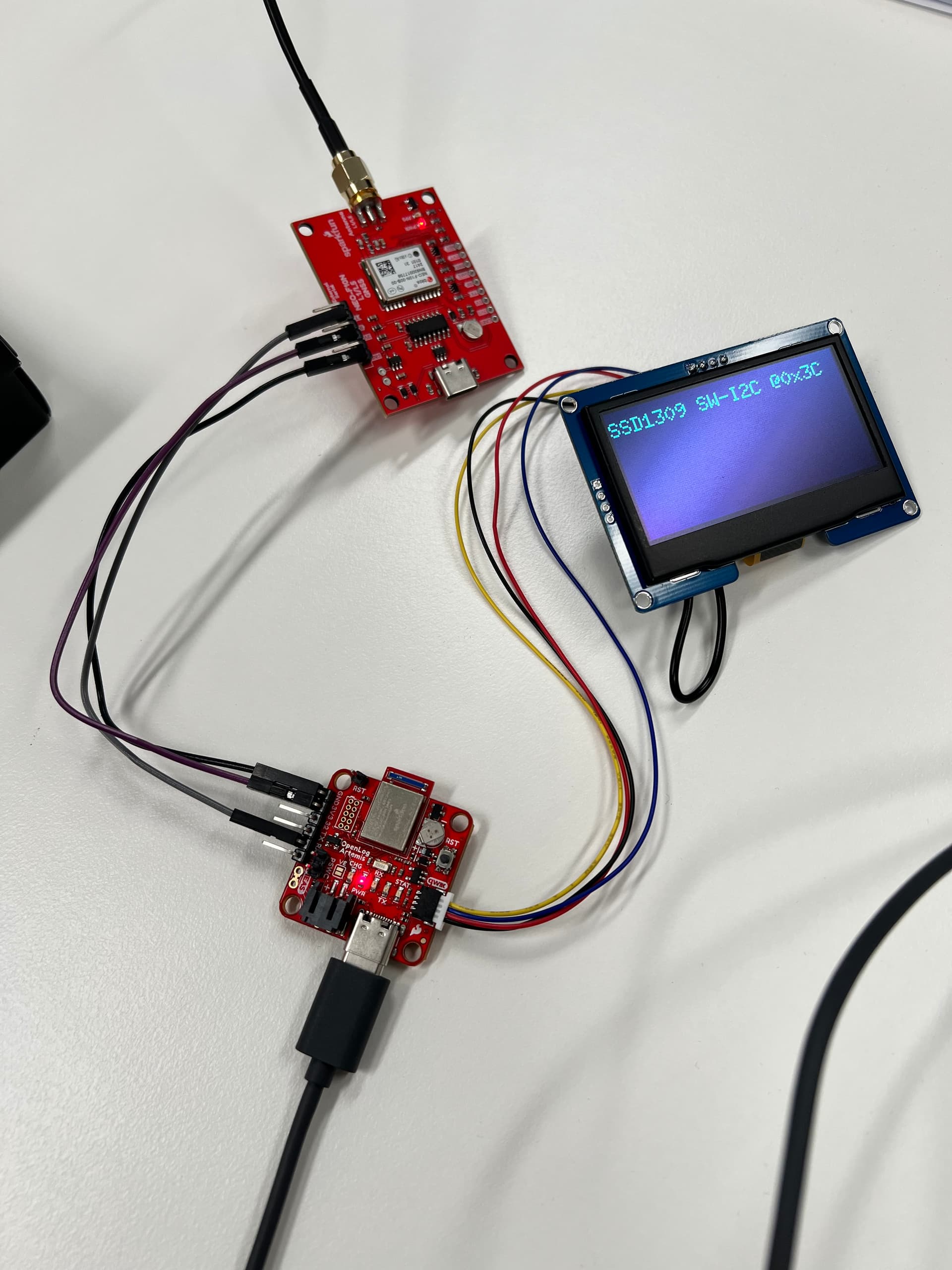

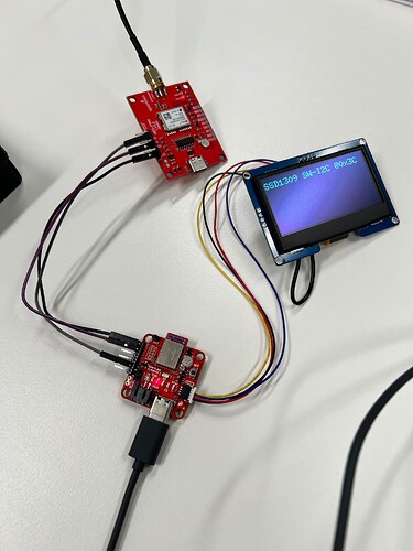

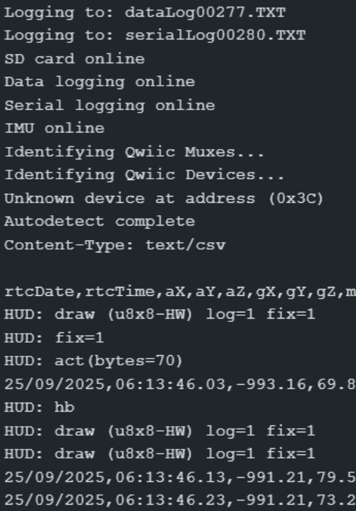

It’s taken a while to get here but I now have the OLA syncing it’s time from the F10N and both the dataLog and serialLog are timestamping. The serialLog is collecting NMEA data from the F10N. I’ve also been able to start up the OLED.
Now the current issue I’m having trouble with is displaying data on the OLED. I’ve been trying to get it to change between IDLE and LOG once it starts recording serial data and getting it to change between FIX and NO FIX once it’s got enough satellites. Do you know if this is possible? Heads up, all the coding has been done by ChatGPT, it’s been a bit learning curve for me and I’ve realised it’s no where near perfect and I need to take baby steps with the code, but it’s got me this far. It just hasn’t been able to display this data yet with more planned. I used the latest firmware as the base and went from there.

After a few months break I got back into trying to get the OLED to work. Originally I was using ChatGPT 5.0 and it’s now on 5.2 so thought I’d give it a crack. No luck, just kept making things worse so movies over to GitHub Copilot. If I had started with GitHub, the whole project would have been done quicker. Worked a lot better in the end than ChatGPT. Took a few tweaks but eventually got it to display everything I want along with recording serial and IMU data at 10Hz. Now to see if I can overlay the telemetry data on a video recording.
I’m sure the code isn’t as clean or efficient as it can be, but for someone with no coding experience, I’m pretty happy with it and I’ve learnt a few things along the way.

I ended up using your GNSS code as a base to simplify the overall setup and remove all the additional sensor data. I had issues with the old code and the GNSS logs being partially corrupted. This new code has helped a bit but only has about 83% of the data I can use, may be a buffering issue. Hopefully I can get that fixed, then I think I’ll have it where I want it. If I can’t upload the files here, what’s the best way to share them?

Just a heads up, this one was all done by Github, going back and forth working on one item at a time. First I got the GNSS logging NMEA data via serial, then the IMU logging, next I had the OLE sync it’s time to my F10N and lastly enabled the OLED. It’s logging RMC and GGA both at 10Hz and IMU data at 10Hz.
