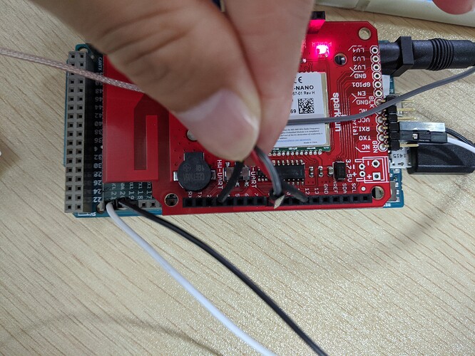

Hi, I have a question…
I’m trying to use the m6e nano rfid reader with an arduino DUE as mentioned above.
Is this circuit of hardware serial connection on below a image correct ?
https://www.flickr.com/photos/130676896 … res/M71204
https://www.flickr.com/photos/130676896 … res/08tdpE
I had obtained a DUE and have been testing without any problems over the past days with the Nano reader. I used Serial1 and had 4 wires connected on the NANO Serial connector : gnd - gnd, VCC - 5V, TXD - RXD (19) , RXD - TXD (18). You are connecting the RXD and TXD to SDA and SCL on the Due, that is NOT correct.
Thank you very much.
I try it again…
make sure to remove the board from the DUE and use it free standing
I understood.
