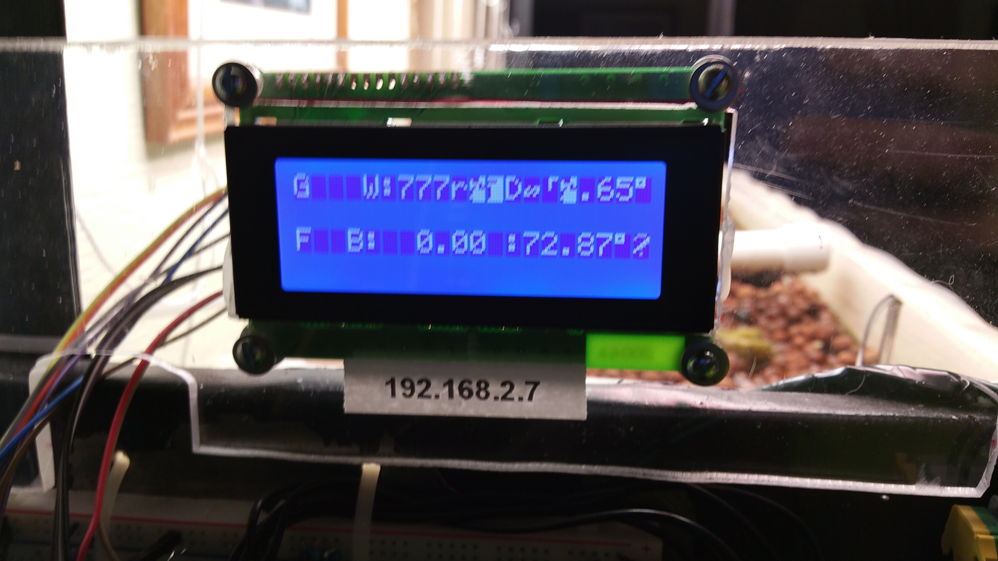

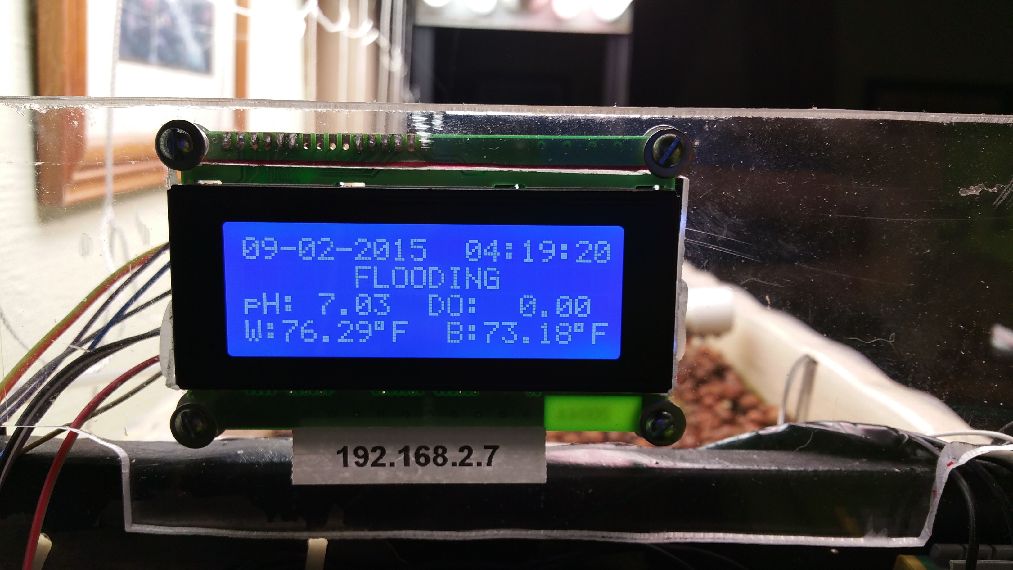

Help with hanging sketch
After some time this sketch on my Mega will start to display strange characters on the LCD and sometimes the sketch will freeze up entirely. I know the Watchdog isnt a way to fix this permanently but I have ordered an Uno so I can use it as an ISP to burn the updated bootloader to the Megas (I ordered another one for fun :smiley: ). This system is to monitor and control an aquaponics system so it running without error is of paramount importance (health to fish and whatnot). I have reduced the sketch from 31% usage of Dynamic Memory all the way down to 12% using a modified form of HTTP GET to just send 1’s and 0’s and then do the logic on the server side. I need an extra set of eyes to go through here and see if they can see anything.

After some time this sketch on my Mega will start to display strange characters on the LCD and sometimes the sketch will freeze up entirely. …
Pictures? Or movie of when this happens? Can this occur in any stage of the processing, or when some conditions are met? This might shed some light on which parts of the code this is going wrong. Being able to look at the code is one thing, but it is also important to see how or when the problem manifests itself.
I was going to suggest some code cleanup before trying to debug. You have tons of global variables and some pretty long procedures. Refactor that into smaller modules and maybe the problem will jump out at you. It’s good that you’re using version control, but your code is likely stomping on one of those globals and you just don’t know it yet.
Ok, so I will type this AGAIN since when I went to post it again the forum told me the page was not found…
I have noticed that when the LCD goes haywire it is usually when one of the pumps, or the recirc valve opens… basically when writing a digital output High.
http://218.m3allc.com/images/lcdnormal.jpg
This is my LCD when all is normal.
As soon as the recirc valve opened (this time, just now) the screen did this:
http://218.m3allc.com/images/lcdfail1.jpg
http://218.m3allc.com/images/lcdfail2.jpg
The first one still shows some recognizable data but then it goes totally nuts and that is what the second one is of. The strange thing is that right now, the sketch is still writing data to the webserver, correctly.
Its like a piece of the transmission to the LCD either gets lost or doesnt get written and that writing a pin high causes the program to skip certain things or freeze. Am I nuts?
