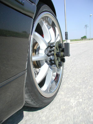

Can you put a wheel tick sensor on your tractor?
By hardware, you can send wheel tick to the F9R, as you mentioned.
You can also send wheel tick or speed by software.
Direction is not mandatory but I would recommend it on a tractor.
BTW, if your tractor looks like the one above, it’s mechanical behavior is different from a car, with all front axle turning and not only wheels. It may disturb F9R fusion engine.
If you can recover REAR WHEEL tick(s) via CAN bus or something, injecting them via software would be more ideal.
