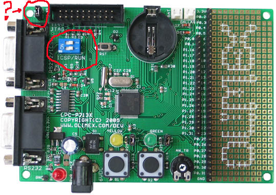

Hi all,
Does the Olimex LPC2138 come loaded with a bootloader? If so, how do I activate it?
I’ve got a JTAG programmer/debugger on order, but it would be nice to load some code before it arrives…

Thanks Leon. I did read the supporting documentation. However, I can’t tell what the proper settings are for the two DIP switch package that are connected P0.14 ( BSL ) and the ICSP. Below you will find the images and text that are relevant to the bootloader. I’ve tried connecting the ICSP serial port to a comms programs and set the DIP switches to various settings and then did board resets… The most I get is the board echoing back my characters, sometimes with garbage. With other settings the board appears to be sending out ‘a’ repeatedly about 1 every second. Since there is no documentation for the board that details how to activate the boot loader I tried what made sense based on the following: ( with no luck ):

Board Image:
http://jimnorton.org/images/LPC-P2138-2.jpg

Ok, after reading the user manual a bit more I realized I needed to send a ‘?’ character to activate auto-baud detection. I can now enter the boot loader commands and the board responds.
Is the LPC Flash writer utility a front-end to this boot loader interface?
You can use that. I prefer FlashMagic. Things are much easier with a JTAG interface, of course.
