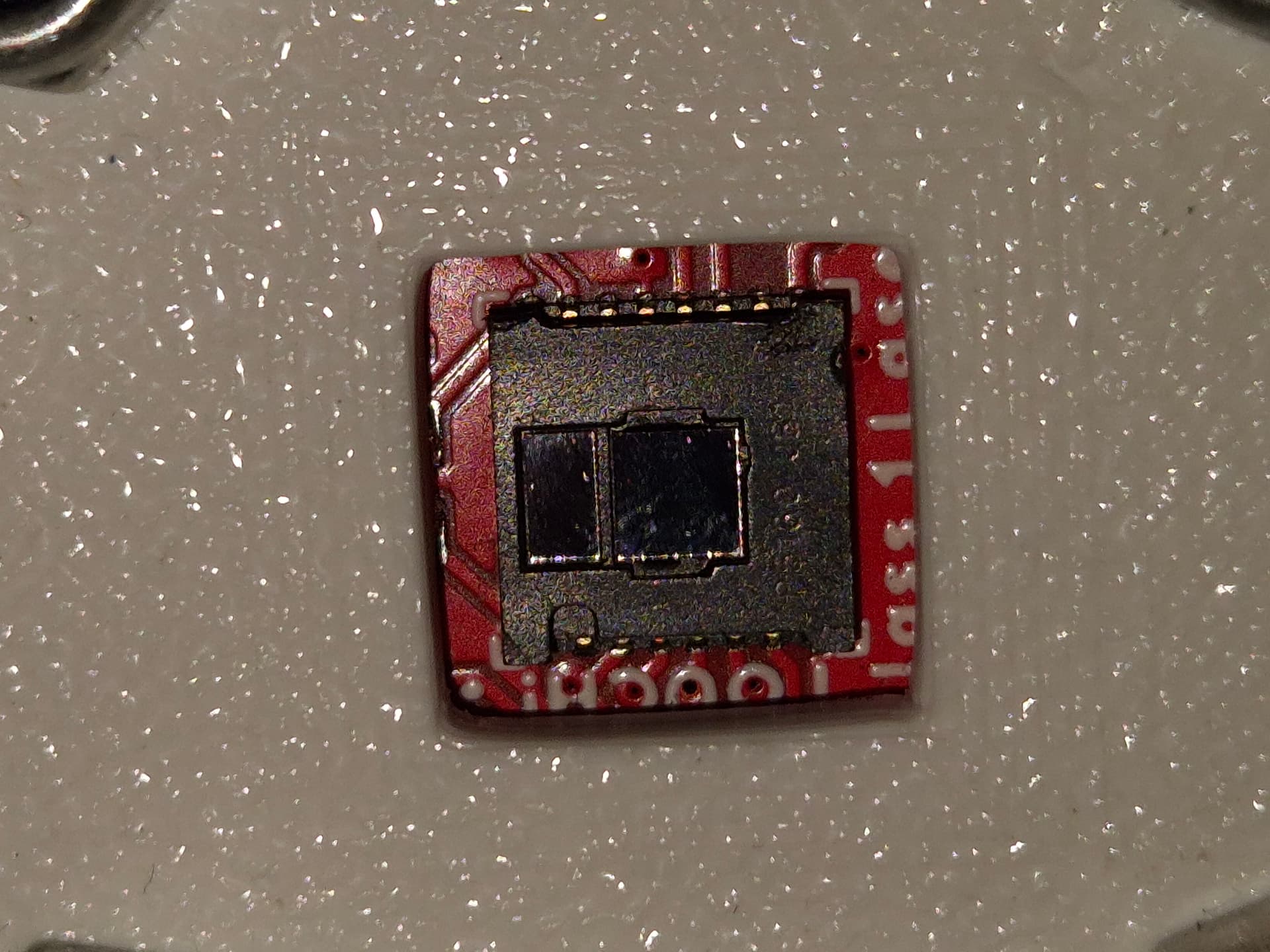

It might also be helpful if you could please take a picture of the sensing element itself, both before and after testing. One problem we’ve observed is that if your robot builds up a static charge, that can attract dust particles onto the sensor and significantly affect its accuracy. I know you said you’re cleaning it, but if dust accumulates significantly during the test, that could explain the problem.

We took pictures before and after running the tests. However, it is important to note that we try as much as possible to keep the field and sensing surface clean, and we did not change anything to the way we cleaned them prior to the errors starting.
Before tests:
After tests:
Thanks! Yep, the sensor looks nice and clean.
