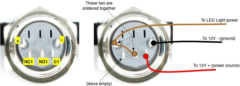

I’m quite the beginner, so I’m not sure if this is possible… I have an On/Off Switch with White LED Ring (https://www.sparkfun.com/products/11970) and I’d like to power the LED inside and use the switch with only two wires. Due to size limitations and connectors for my project, I’m trying to keep the number of wires and connectors down. Using an arduino for this project.
My preliminary research suggest I’ll need three wires, but curious if this is this possible? If so, how would you go about this?

I believe I need to connect three wires to the switch. I’m running 3.3-5v to the switch to trigger something via a microcontroller.
Have you poked around with a multimeter in diode/resistance mode on those pins? Maybe you can identifty between which pins the led is connected, and it’s polarity. The multimeter should give out a constant current which should make the led light up (dimly). At least, this seems to work for most red and yellow leds I have. Maybe not for white and blue leds. Also find out which pins to make the switch function.
I’ve found a decent wiring diagram and I’ll definitely have to use three wires, but shouldn’t be an issue in the end.
It might help others if you share this diagram. At least satisfy my curiosity. :slight_smile:
Of course. This may not be the exact one I was looking at (different voltage listed), but it is the same wiring configuration: http://www.oznium.com/images/stainless- … wiring.jpg.
