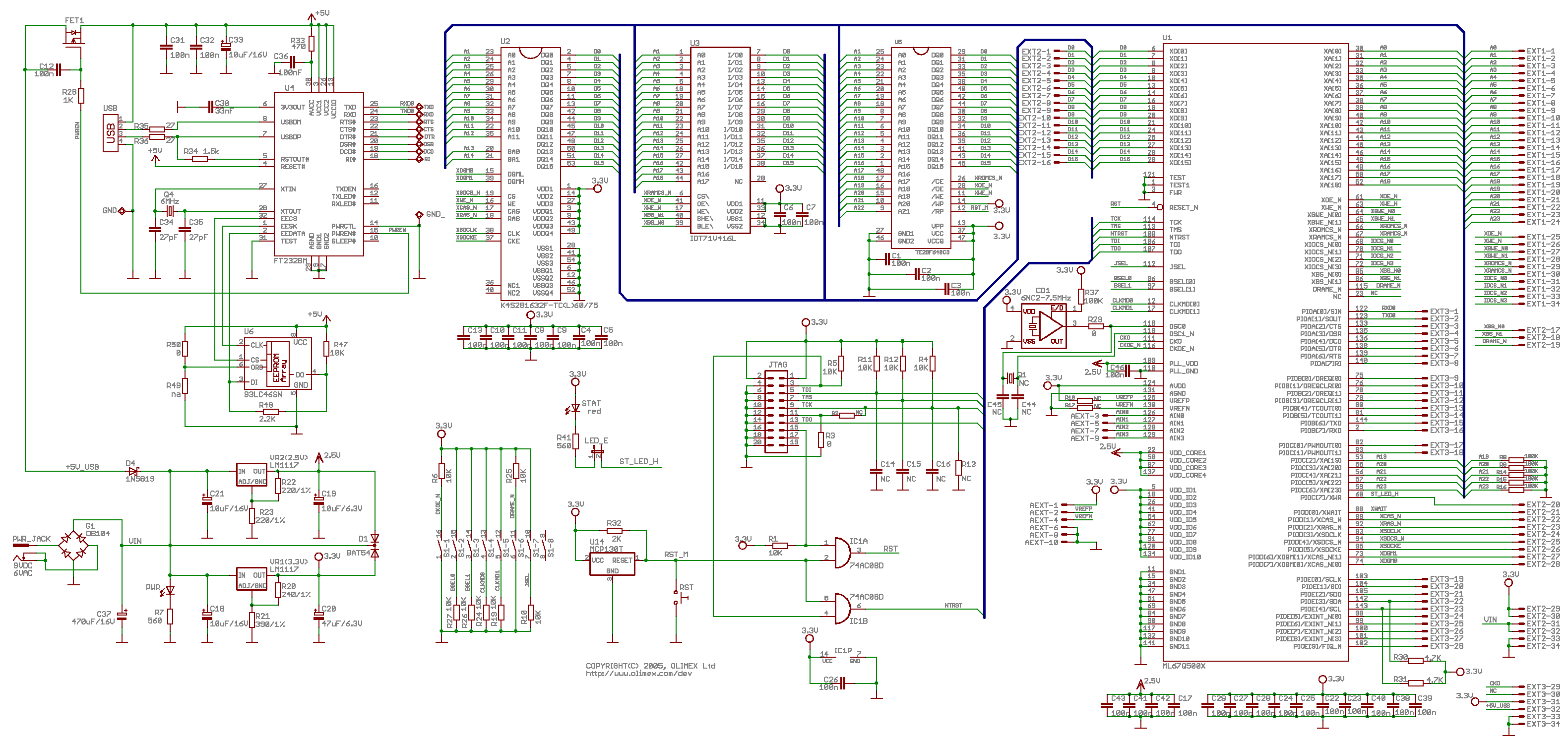

Ok, so about the backside of this thing, I notice 4 buses, marked EXT1, EXT2, EXT3, and AEXT
Is there a straightforward way to write programs to interface with these? And if so, how do I do that, or where might I find some solid, comprehensible information on it?

You can see what pins are available by checking the schematic:
http://www.olimex.com/dev/images/oki-h5003-sch.gif
The ports are labeled EXTx-x, for instance EXT1-1.
I am not familiar with this OKI processor to tell you how to deal with the GPIO ports, or the processor peripherals. I suggest downloading the processor datasheet from OKI.
Note that a good number of the IO pins are tied to the memory bus (NOR flash, SDRAM, SRAM). Great if you need the memory (such as running ucLinux), not so great if you want a lot of general purpose IO pins. The board has a ton of features you’re not exploiting :slight_smile:
