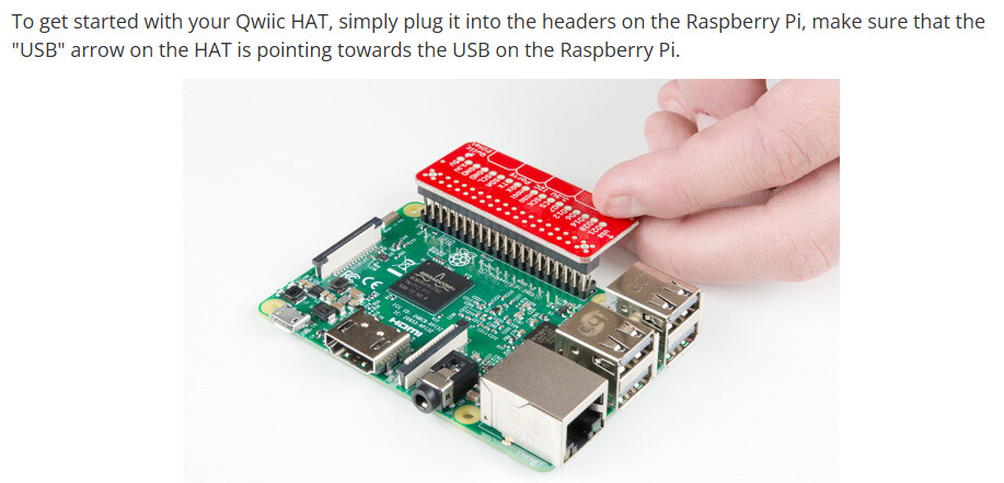

i think this chip is not working correctly. follow the test pattern and code. let me know the official test from spark-fun to test to see of the board is good or not. What is required to get my sensor discoverable on the PI 5?
# QuickHat Complete Test Report
**Date**: 2025-12-02
**Purpose**: Determine if M.2 HAT interference or QuickHat itself is causing I2C sensor communication failures
**Hardware**: Raspberry Pi 5, QuickHat (SparkFun Qwiic PiHat), M.2 HAT (NVMe boot), GPIO Riser (if applicable)
## Test Configuration Summary
| Test | Configuration | Status | Result |
| **Test 1** | M.2 HAT + QuickHat (stacked) | :white_check_mark: Completed | :cross_mark: Failed |
| **Test 2** | QuickHat only (no M.2 HAT) | :white_check_mark: Completed | :cross_mark: Failed |
| **Test 3** | QuickHat only (no GPIO riser) | :white_check_mark: Completed | :cross_mark: Failed |
## Test 1: M.2 HAT + QuickHat Stacked
**Date**: Prior testing (before 2025-12-02)
**Configuration**:
- Raspberry Pi 5 (bottom)
- QuickHat (middle of stack)
- M.2 HAT (top of stack)
- GPIO Riser: Unknown/Not documented
**Hardware Stack**:
Pi 5 β†’ QuickHat β†’ M.2 HAT

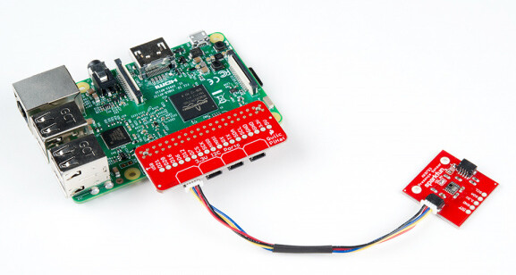

## Overall Analysis
### Key Findings
1. **M.2 HAT is NOT the problem**
- Test 1 (with M.2 HAT) and Test 2 (without M.2 HAT) show identical failures
- QuickHat routing issue exists regardless of M.2 HAT presence
2. **GPIO Riser is NOT the problem**
- Test 2 (with riser) and Test 3 (without riser) show identical failures
- QuickHat routing issue exists regardless of GPIO riser presence
3. **QuickHat I2C Routing Failure**
- Sensors should appear on bus 1 (GPIO I2C) but do not
- QuickHat documentation states it routes GPIO I2C (SDA/SCL) to Qwiic ports
- This routing is not working in our configuration
4. **Phantom Devices on Bus 13/14**
- Both buses show many addresses in i2cdetect scans
- Cannot actually read from these addresses
- Suggests I2C multiplexer or bus controller misbehavior
5. **Sensor Communication Failure**
- Cannot read from RTC (0x68) or IMU (0x28/0x29) on any bus
- Suggests either:
- Sensors not properly connected to Qwiic ports
- QuickHat not routing I2C correctly
- Physical connection issues (cables, seating)

Here are more photos from the hookup guide. Please check you haven’t installed the HAT upside down. As @YellowDog says, there is really very little that can go wrong on the HAT itself.
