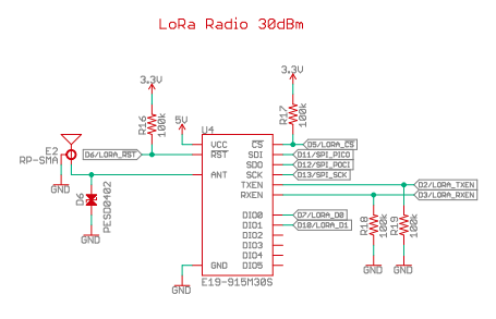

@sparky I switched to P2P mode, ran a airspeed of 9600 and got about 300 feet down the street and my base is in my backyard and I strapped the omni antenna to the tripod leg (literally so terrible LOS) so I ordered a pole clamp so I can get it up higher and away from the tripod. I was curious wouldn’t it be a benefit to switch the jumper to 5v to feed the LORA the lipo battery voltage and help the power levels just a little bit more?
The RADIO port on the Postcard will feed either 3V3 (default) or 5V out. So yes, modifying the VSEL jumper to 5V should provide the LoRaSerial with additional gain.
I applied 5v and was able to go 1000 feet in my subdivision so again not great line of sight. But glad to finally get Loraserial working. I was able to run 4800 baud. I did get a couple channel hops but mainly when I was walking probably as it tried to find the base again
Lora at 2000 feet apart it worked I will compare versus ppk and RTN RTK on the correction network. But fantastic that it worked to check into a benchmark. @toeknee you couldn’t topo with it but for an elevation certificate
