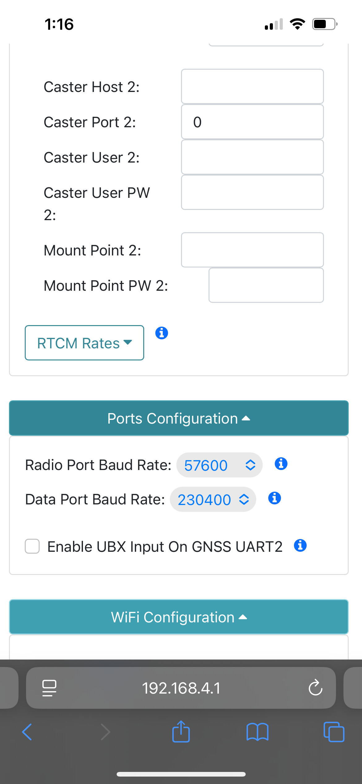

I need to get this thing up and running. We use it every day with multiple rovers and “unskilled" labor. Having to reset it constantly is getting to be too much. I really feel like it is a network issue with the surveyor. We connected it to another router that runs off the same building internet and it comes back online sooner, but still stops broadcasting very frequently. I am going to try and hook it up to a hotspot today and see if that helps.
It definitely stops broadcasting through the internet because as soon as the lights stop flashing/alternating, Emlid caster says the base station goes offline.
Just tried my iPhone hotspot and it won’t stay connected. It picks up and immediately drops.
I have unplugged the usb-c from the surveyor.
I am confused - why? I recommend you disconnect the internal battery and use external power exclusively.

So we set up another wifi and connected to that. I removed all other wifi connections in the settings. Thus far everything is working for 24+ hrs. It must be the other networks were kicking the unit off for some reason.
Ok so new problem, I dont know if the problem lies with the rtk surveyor or something else. The unit is connected to wifi and emlid caster says its online. My rovers can connect, but get an error code “No Recent Correction Data.” I take this to mean that the surveyor is not broadcasting data. Resetting the surveyor twice today has fixed the problem.

Nope. And the unit is still not broadcasting data. I really need to get something figured out quickly
We are able to ping the IP Address 192.168.4.1 through the network so I guess that means the unit is connected to the network but is not broadcasting correction data
Your serial output indicates an IP address of 192.168.1.40. I’m not sure why 192.168.4.1 is showing up. This is commonly the IP address of an RTK unit that is broadcasting its own access point used during device Web Config as shown by your previous posts:

I really need this a base station up and running. We are using it constantly. I would prefer if ya’ll could send out a new RTK surveyor with a return ship label so I can send this one back.
It doesn’t look like a hardware issue, instead it looks like Emlid is refusing the connection. There have been reports that Emlid is down (even 4 minutes ago). See here. Please try a different caster like RTK2Go. I’m not sure what’s going on with Emlid - normally they are very dependable.
If you want to share your Emlid mountpoint credentials with me via PM I can test the connection.
