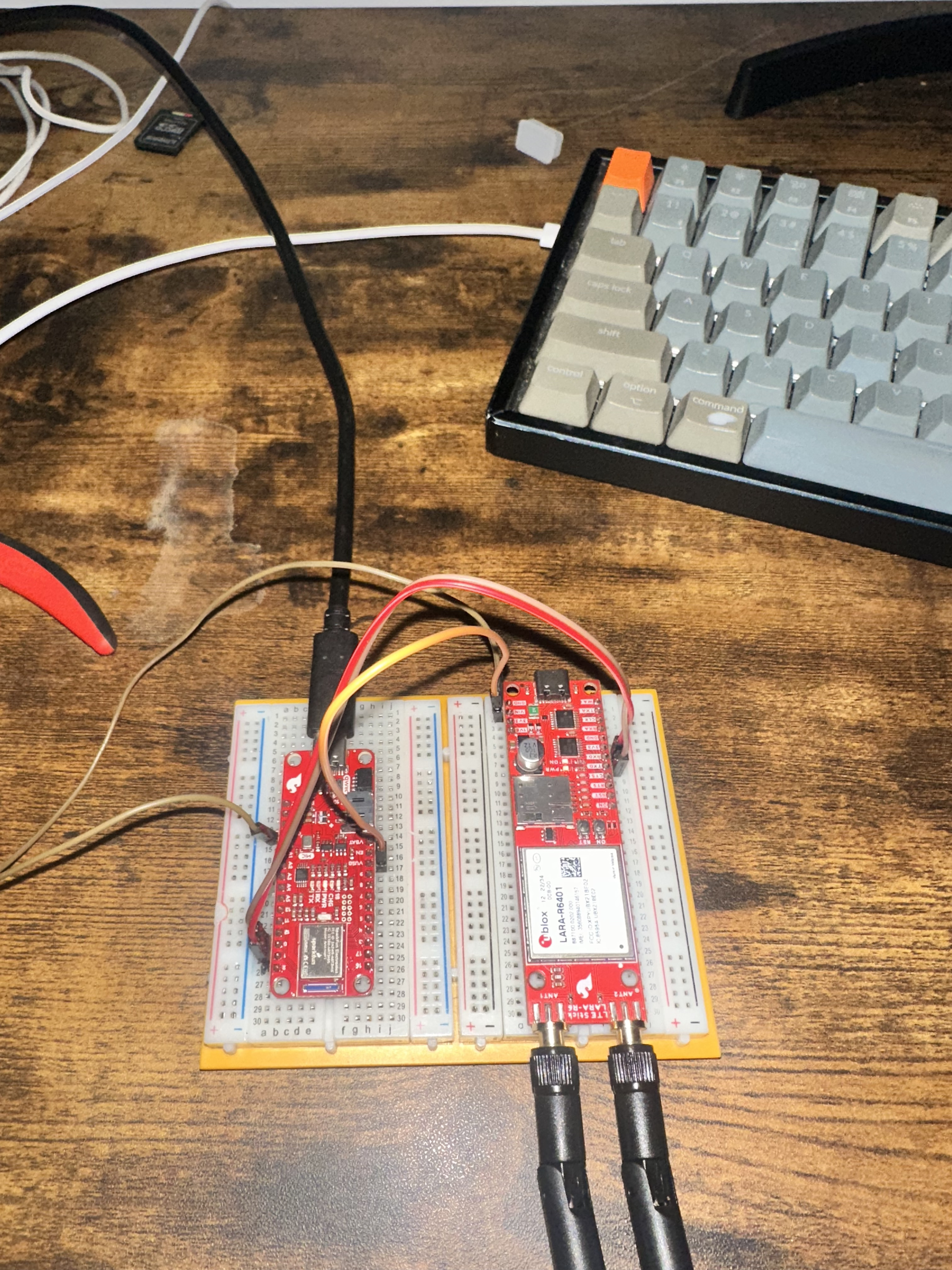

I’m unable to get the LARA-R6 module to respond to AT commands via UART or enumerate as a USB device. I’ve tested two different LTE STticks with identical results.
Setup:
  • SparkFun Artemis Thing Plus
  • SparkFun LTE Stick LARA-R6
  • Wiring: Artemis Pin 1 (TX1) → LARA RXD, Pin 0 (RX1) → LARA TXD, VUSB → VIN, GND → GND
  • Power: Via USB-C directly to LARA-R6
  • Code: SparkFun u-blox Cellular Library Example 1
  • Macbook Pro - (Cannot install u-blox m-center)
Troubleshooting completed:
  • Verified Artemis Serial1 working via loopback test
  • Confirmed correct TX/RX crossover wiring with continuity testing
  • Verified all solder jumpers (PWR_LED, ON_LED, DTR) are closed
  • Both PWR and ON LEDs illuminate when powered
  • Tried multiple power-on sequences (tap once, hold 3 seconds to off, etc.)
  • Tested with module powered via both Artemis VUSB and direct USB-C
  • SIM & antenna installed
Result: Module fails autobaud with “Module failed echo test” error. LARA-R6 does not appear as USB device in system. Same behavior on both modules tested.
Any suggestions?

Ah, I found something. The LARA is 1.8v Hardware Overview - SparkFun LTE Stick - LARA-R6 Hookup Guide
https://cdn.sparkfun.com/assets/8/9/5/2/1/SparkFun_LTE_Stick_LARA_R6.pdf
and the Artemis is 3.3v, you’ll need a level-shifter to have those chat

Thanks for your response regarding the voltage levels. However, I need clarification on something in your documentation.
According to your Hardware Overview page, the 1.8V warning specifically states:
“All three of these clusters have test point connections for 1.8V and GND and connect directly to the associated pins on the LARA-R6. These pins are not level-shifted and run at 1.8V logic.”
This warning explicitly refers to the test point clusters (I2C, GPIO, and UART2) on the back of the board - not the main PTH header pins (RXD, TXD, CTS, RTS) that I’m using for UART communication.
Additionally, your Introduction page states:
“The LTE Stick operates at 3.3V logic so make sure your chosen development board operates at the same logic level or use a level shifter.”
Furthermore, your Hardware Assembly guide shows direct connection between the ESP32 Thing Plus and LARA-R6, instructing users to connect VUSB to VIN. As documented in your ESP32 Thing Plus hookup guide, VUSB provides ~5V from the USB connection. The same VUSB pin configuration applies to the Artemis Thing Plus. This is the exact wiring I followed.
Can you please clarify: Are the main PTH header UART pins (RXD/TXD) 3.3V or 1.8V logic? Your documentation consistently indicates they should be 3.3V compatible.
More importantly, regardless of the voltage level question, both LARA-R6 modules fail to enumerate as USB devices when connected directly to my Mac via USB-C. They do not appear in System Information or create any /dev/cu.* devices. Summary of issues:
  • Both LARA-R6 modules do not respond to UART communication from Artemis (3.3V logic)
  • Both modules do not enumerate via USB when connected to computer
  • My Artemis Serial1 port appears damaged after connection attempts - See post above test fails in 2 devices after following hookup guide.
  • Powered via 5V (VUSB to VIN) as shown in your assembly guide
Could you please advise on next steps? I believe these modules may be defective, or broken as a result of following the hookup guide.
