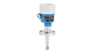

Another neat technique measures the mechanical resistance to paddles vibrating in the fluid, a viscometer. I’ve never used them for the purpose but seem to be [immerse Y/N?] for run-dry/overtopping detection than level measuring. They’re sometimes genericized as Liquiphants for this mfg’s tradename:
