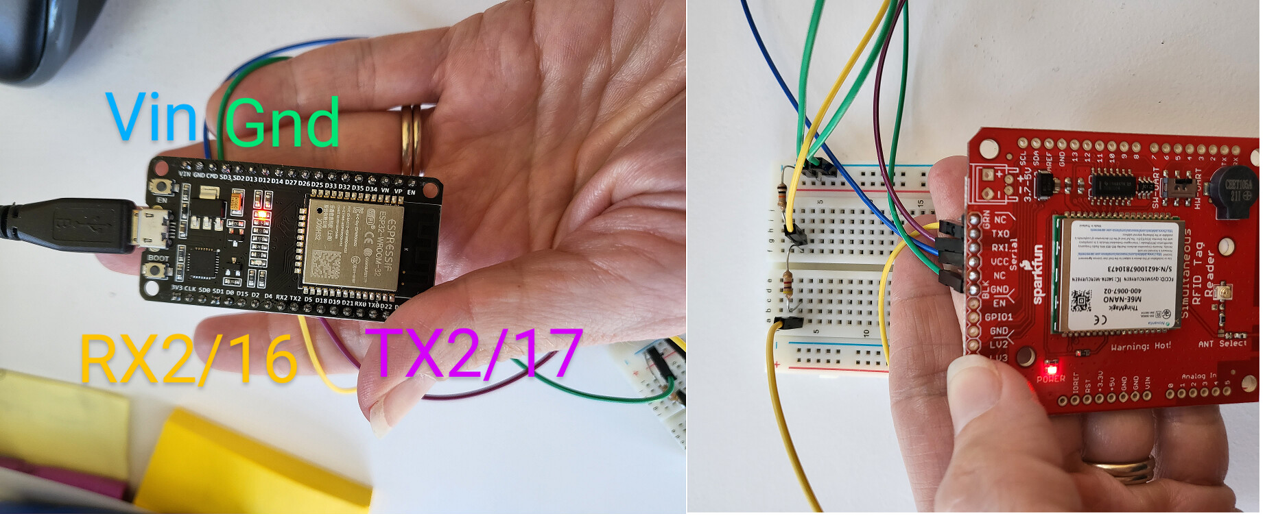

Attached a picture of my current setup.
Hi, I have the same problem… I can’t comunicate the esp32 with the M6E Nano.
I am using the code shared by paulvha (example1_ESP32) and the conection like the his picture.
I tried connected the VCC of the Nano to 5v and 3.3V and the answer is the same “Module failed to respond. Please check wiring”

  • 1. Remove the external antenna for now and also the plastic cover.
    1. Make sure the pins on the sides of the NANO are not connecting/touching to anything.
    2. Your connection looks correct to me. You get the power (else the led would be off).
    3. It must be connected to 5V, else it will not work.
    4. Make sure the serial2 is selected and thus pin 16 and 17.
    5. Power all OFF and ON again. (once the NANO is in a state of flux it needs a power cycle to restore.)
    6. if you happen to have a USB/serial FTDI, you could try with the URA on Windows
    7. double check that your breakwires do connect correctly. Have had situations where that was not the case[/list
  • Hi, I did all the instructions and nothing.
    check the wire, and nothing
    I work in linux… I will try to install a virtual machine with windows and test with URA.
    I know the problem is between the m6e nano and the esp32 because I test with a SparkFun RedBoard and work very well.
    try to connect the TX and RX lines together near the Nano and see what debug message you get.
