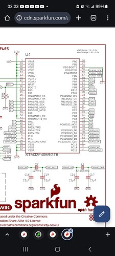

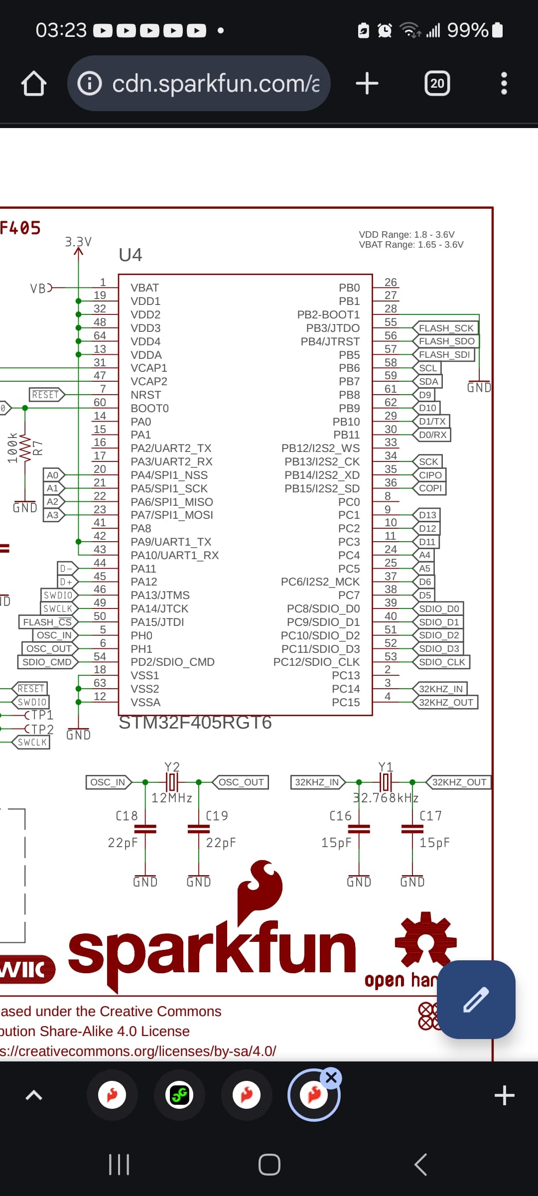

Do these help?

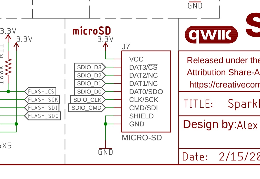

Thankyou Yellowdog. I had found the circuit diagram and eventually translated SDIO_CMD to COPI; SDIO_D0 to CIPO; SDIO_CLK to SCLK; and SDIO_D3 to CS. Unfortunately the sd routine using these pins did not work and I just get a failed to initialiase error whereas almost similar code for the STM32 microd datalogger worked fine. I used the PCx, PBx notation for the pins.

After waisting months of time wondering whether my unit was faulty or not, I tried some other SD library files. It seems that SDIO cannot use SD of SdFat libraries but requires STM32SD.h instead. It would have been good if Sparkfun had told us that this was a suitable library. This library got the sd card logging OK, but introduced another problem. In order to append data it is necessary to seek to the end of the file before writing. In a large file such as mine (>10,000,000 lines after a month of data) the overhead to seek to the end of file slows the logging time by a factor of 4, which is totally unacceptable. I have not been able to find a workaround for this issue. On my working MM stm32F405’s this is not an issue since they use the SD.h library, so there is no loss of logging speed.
