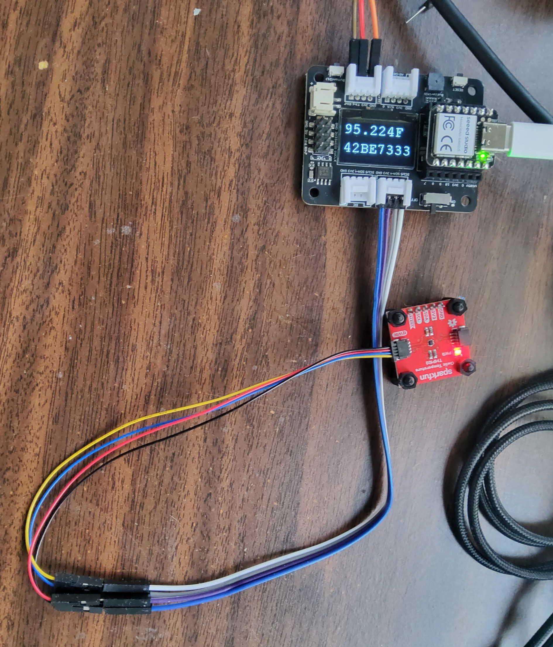

I can do Seeedruino XIAO easily, the extension base board comes with 2 x I2C port, I just need to set sensor0.begin(0x48, Wire) to avoid conflict with OLED address.

sorry after I give up trying on UNO Q I delete the code, I have try Seeed XIAO board, easily get it work with same sample code. connection as picture
