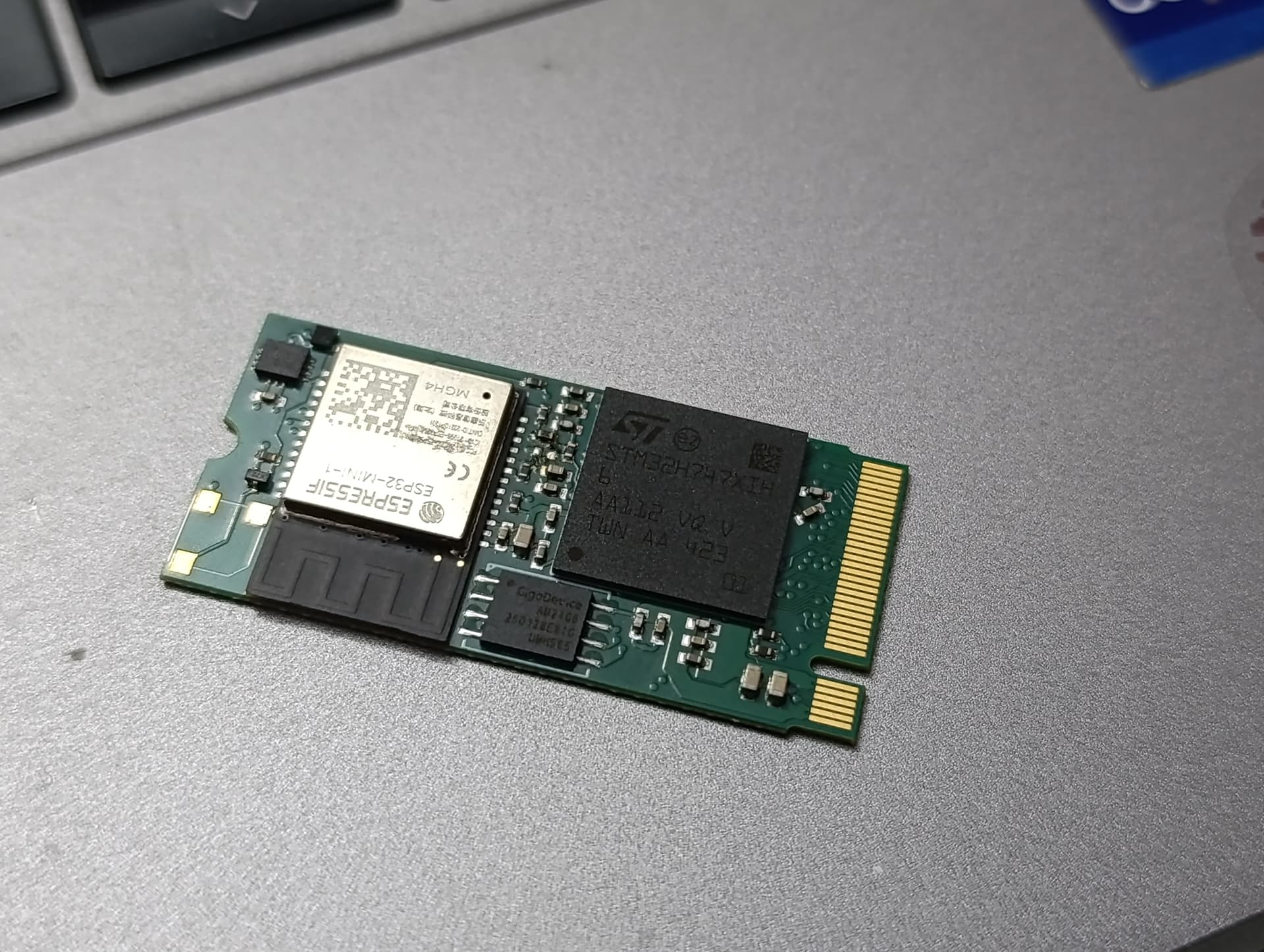

Hello everyone,
I am new to this community. I recently discovered the MicroMod ecosystem and seems like a nice idea.
However, I have seen that it lacks some serious computing power. So I have decided to create a MicroMod, packing an STM32H747 with 16MB SDRAM and 16MB external Flash and full blown Bluetooth and WiFi capabilities.
I am making this post to see if there is interest in this contraption and if there are other functionalities that I missed, so let me know what you think about this.
It has most of the interfaces specified in the MicroMod documentation, however it has only one USB 2.0(480Mbps) and SDIO can not be configured as SPI(limitation of the STM32 pinout.
On the plus side, it has 166MHz SDRAM(16bit data bus), 56Mbps WiFi(LBEE5KL1YN) and a dedicated 2 lane DSI interface(up to 10Gbps bandwidth).
To keep the cost somewhat low, The board size was increased to 23x27mm, but it is fully compatible with MicroMod socket.

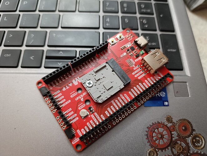

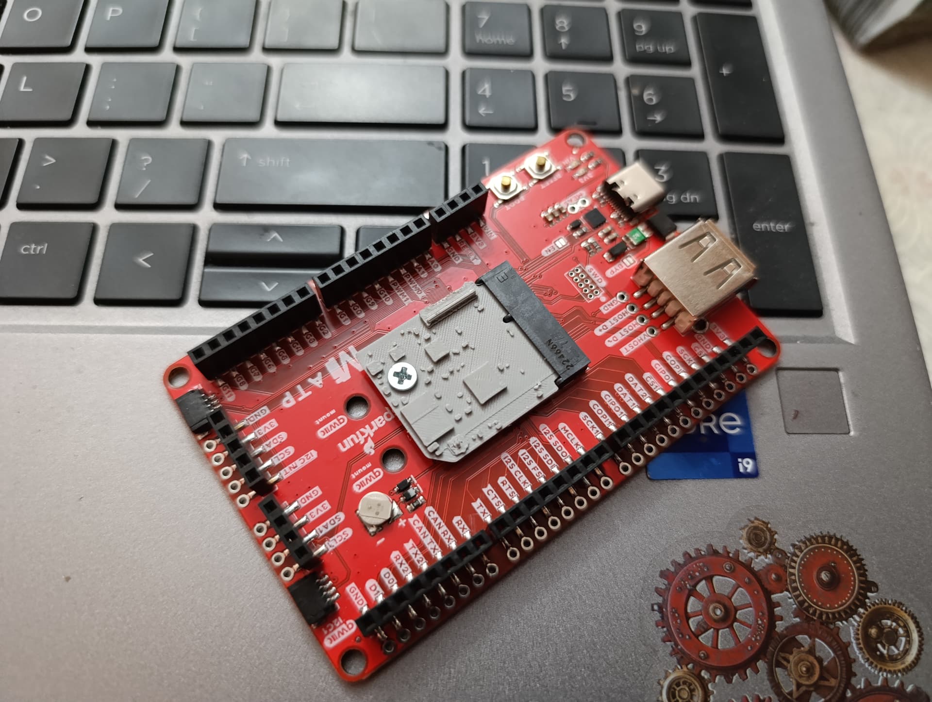

It is still work in progress, but here is an early preview:

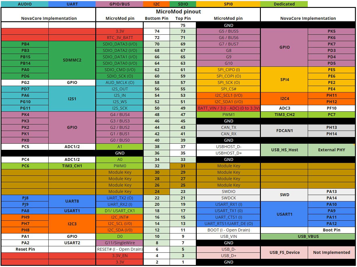

Hello again, coming back with updates.
I have decided to switch to STM32H757 MCU. It is slightly more expensive, but the added security justifies the small added cost.

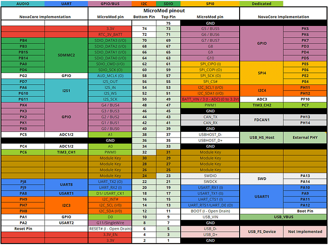

In another order, below is the M.2 edge pinout. In the center, the MicroMod standard pinout is shown and on the outsides are the assigned peripherals.
Thank you for the interest and I will keep you posted with the updates as I go!

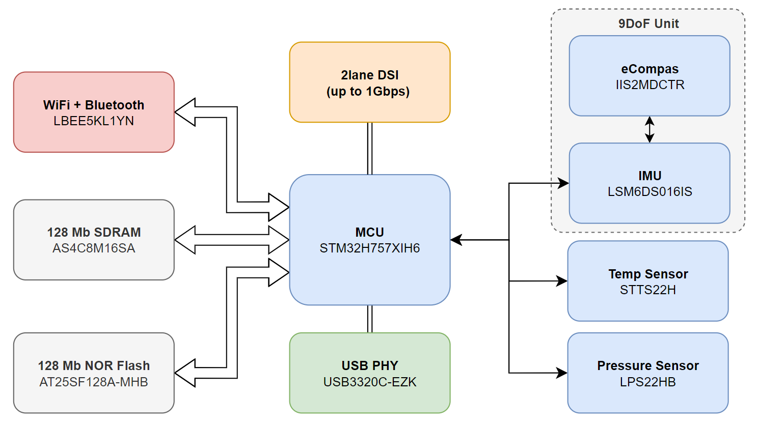

Below is a block diagram, showing the main blocks in the module and how they are connected. In order to simplify the diagram, the M.2 edge connector is not shown.

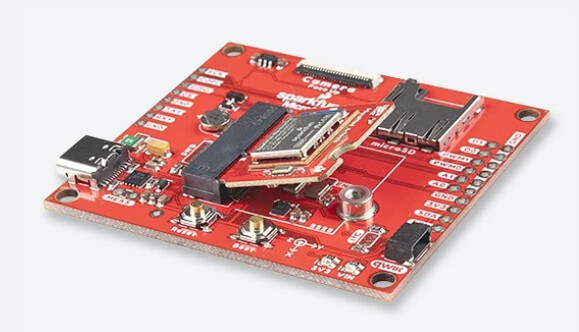

Image from the SparkFun website
Then, about two months ago, everything changed. I was browsing the web when an ad for a SparkFun MicroMod module popped up. The promise of a standardized ecosystem, compatibility with many carrier boards, and a tiny 22x22mm footprint immediately caught my attention.

    • Add Memory: I added 16MB of external SDRAM to enable complex IoT tasks and even run Edge AI applications.
    • Integrated Sensing: Since there was space, why not? I integrated a full suite of ST sensors:
      • A 6-axis IMU and an eCompass for navigation.
      • Temperature and Pressure sensors for environmental data.
One of the most exciting parts is the sensor integration. The IMU and eCompass are configured so the IMU can directly sample the eCompass and perform sensor fusion internally. According to ST, this should allow it to output true 9DoF quaternions right from the hardware—a feature I can’t wait to test!
