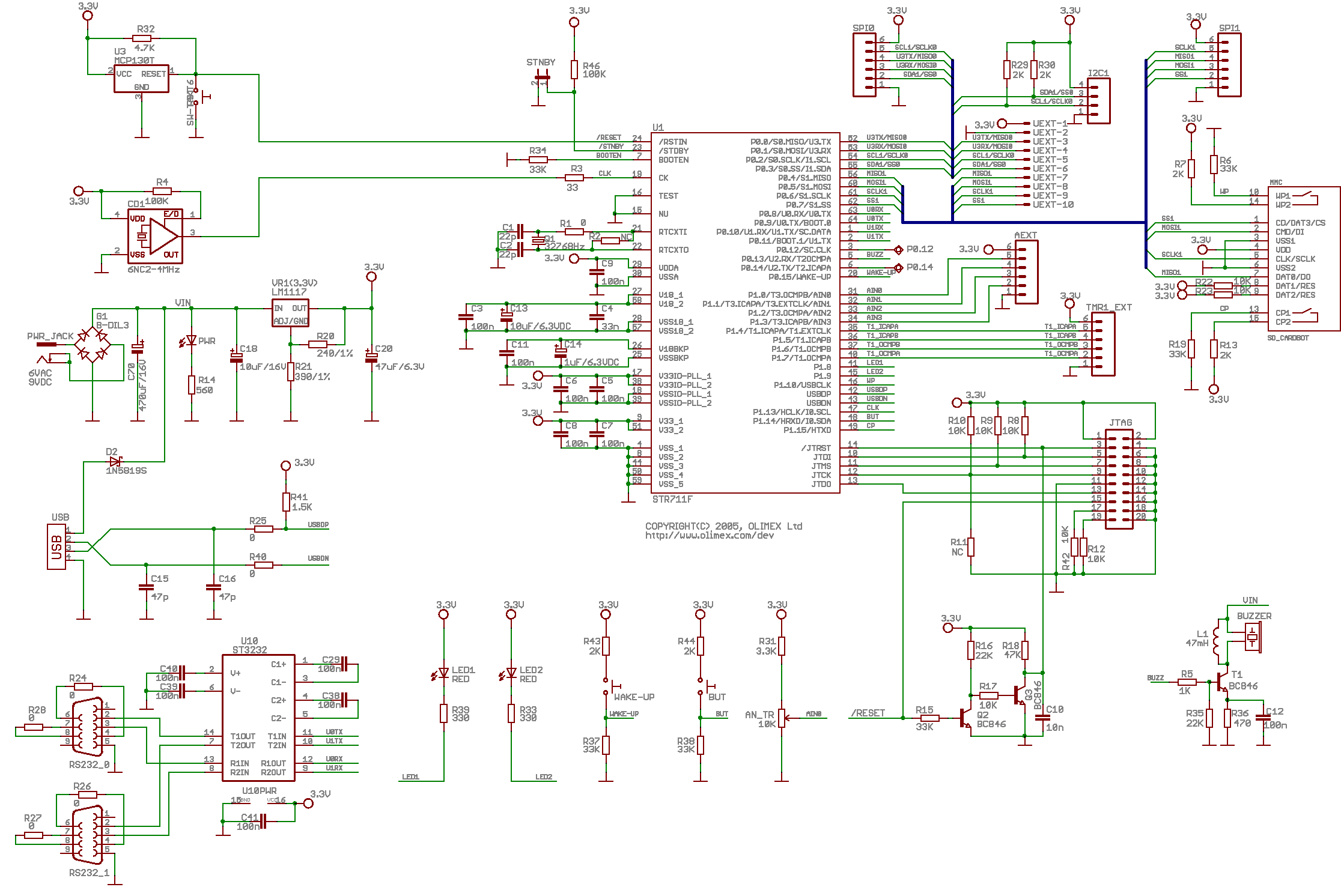

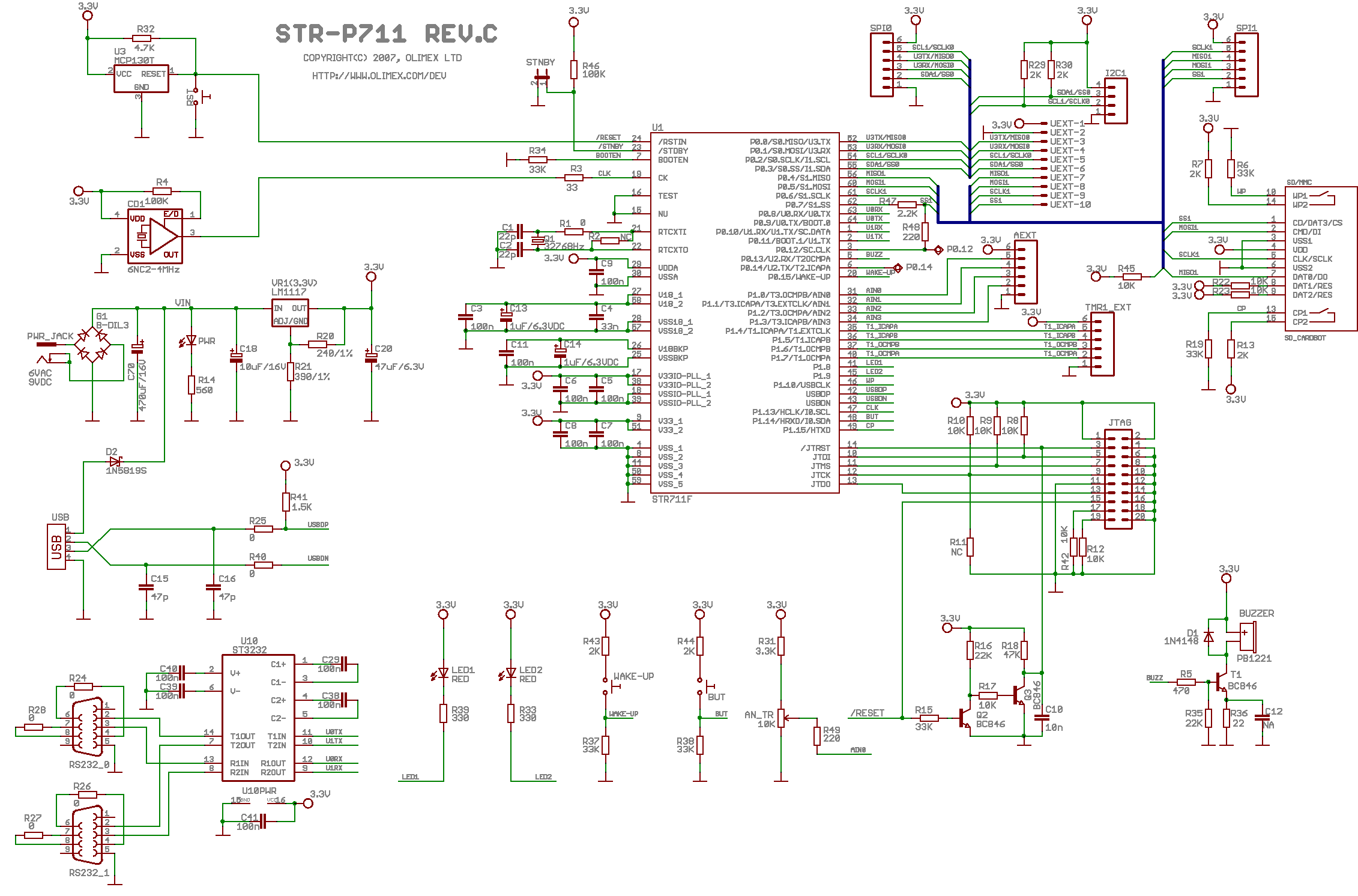

The SS1 signal out of the ARM cannot be used to select the SD card as I suspected. The Olimex code apparently expects there to be a jumper between P0.12 (which is one of the pins right next to UEXT, I didn’t see it at first) and SS1 on the SPI1 header. Additionally, there is a resistor (R47) in between the SS1 signal on the ARM and the other SS1 connections (which doesn’t appear on the schematic as far as I can tell), which allows you to set SS1 to an output and assert it while at the same time pulling SS1 low on the SPI1 header without creating a short.

There is indeed a 2.2k resistor between the SS1 on the chip and the rest of the connections. However, I also noticed a 220 ohm resistor between P0.12 and SS1 on my board. (Both of these resistors are on the back of the board.) I don’t know if you actually connected a wire between the two pins, but it appears to work fine without it, with the 220 ohm resistor as the “jumper”.

So you both agree that you can not use the SS1 Pin as an GPIO while you are using the SPI1? because thats what I’m trying at the moment. I have configured SS1 as TTL Push pull, and make my chip select signal with this. But i only read 0x00 from my MM-Card.
Could anyone of you update the olimex schematics?
http://www.olimex.com/dev/images/str-p711-sch.gif
Just paint the resistors, so that I can see what you tryied to say… :wink:

1- you can not use P0.7 (SS1 pin) to select the SD/MMC card because when you select SD card by pulling SS1 to low,you make your microcontroller SLAVE,not master.(you can check from STR7 user manual) So you should use some other pin, P0.12
2- Both P0.12 and P0.7 should be configured as output and you should pull P0.7 high ALL THE TIME and pull P0.12 low/high anytime you are supposed to.
You can check what I mean from the schematic from olimex site.
http://www.olimex.com/dev/images/ARM/ST … -C-sch.gif
you can easily see the 2.2K ohm and 220 ohm resistors.
