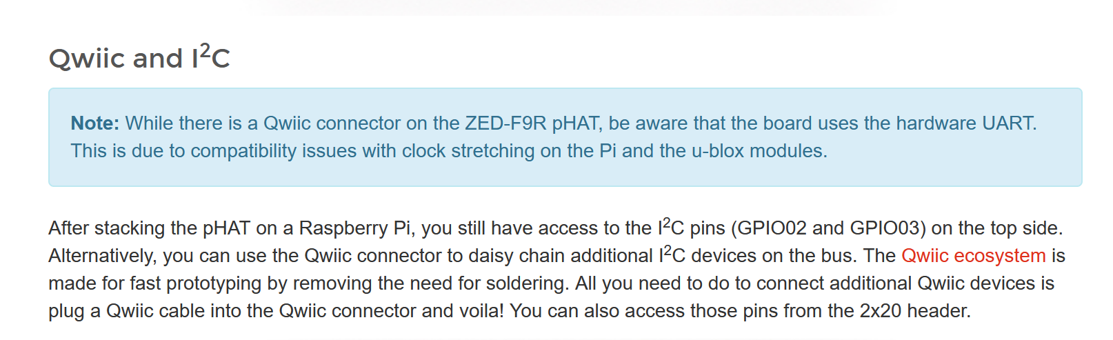

    Look back at the posting Fri Dec 04, 2020 4:42 pm in this topic, discussed the GPS-RTK Dead Reckoning ZED-F9R PHAT.
    I’ve been searching through the forums to understand why the PHAT will not communicate over I2C.
    The posting from Wonder Boom Fri Dec 04 says the I2C is not connected and then points at the ZED-F9R PHAT documentation which STILL says it is, even now, a year later.
    On my system…
    PHAT is communicating via serial, but will not show as an address on I2C, if I stack an I2C serial board on top, the serial board is recognized and works.
    So working PI, working I2C bus, only one direct connection possible from PI<->HAT, despite 4 being available on the ZED-9R.
    ZED-9R UART2 is normally reserved for RTCM, UART1 for data, I2C and SPI for anything.
    The only way I can make your board work is by stacking an I2C serial board on top and connecting it to the UART2 connection on the PHAT.
    It doesn’t look like I2C is connected to the GPS, only the qwiic connector.
    The [schematic shows the GPS being connected via UART to the pi’s RX and TX pins but I2C isn’t connected to the module.
    ](https://cdn.sparkfun.com/assets/2/c/0/8/6/SparkFun_GPS_ZED-F9R_pHat_Schematic.pdf)
