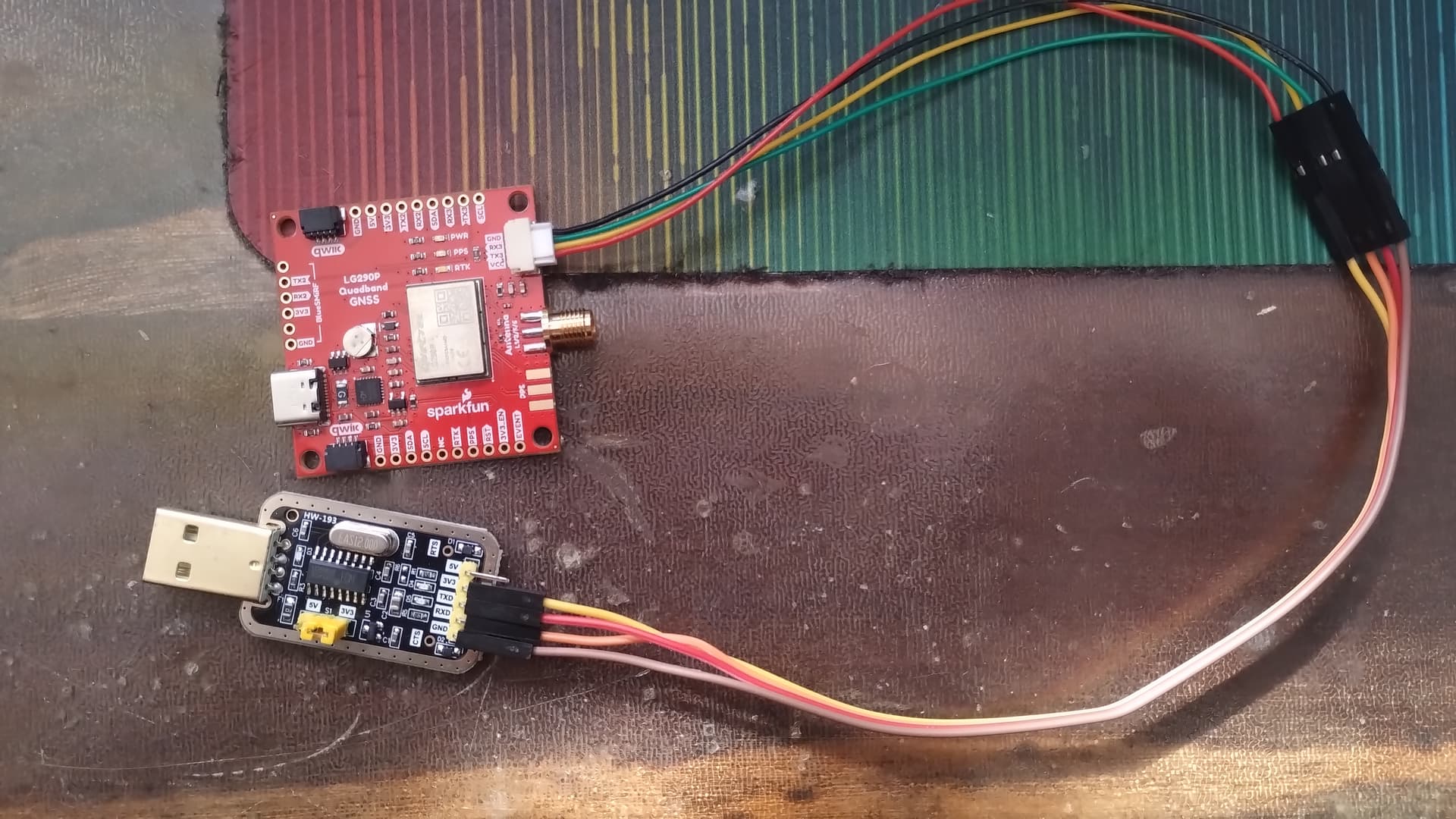

I have the SparkFun Quadband GNSS RTK Breakout and was testing the UART communication on my board.
Communication over UART1, which is connected to the board’s USB port, works as expected.
However, when I try the same setup using UART2 or UART3, I receive no response.
Here is the UART console, where you can see there’s no response from the board:
The first command in the console is a reset command, which the chip seems to recognize — the PPS LED stops blinking while the chip resets.
Initially, I suspected the USB-to-Serial adapter might be the issue, but I tried a second adapter of the same type and observed the same problem.

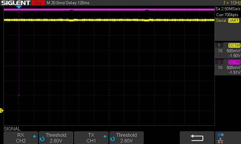

I then connected my oscilloscope while testing UART3 communication again.
I confirmed that the command is correctly sent and that there is no response from the board.
Could it be that UART2 and UART3 are non-functional on my board? Or is there a setting I may have overlooked to enable these UART ports?

Here is a picture of the setup I was using:
As you can see TX and RX are crossed, GND’s are connected and it is a 3.3V adapter.
I am powering the board via the adapter and JST connector.

Here is a screenshot of the oscilloscope screen, confirming the voltage levels and the missing response from the board:

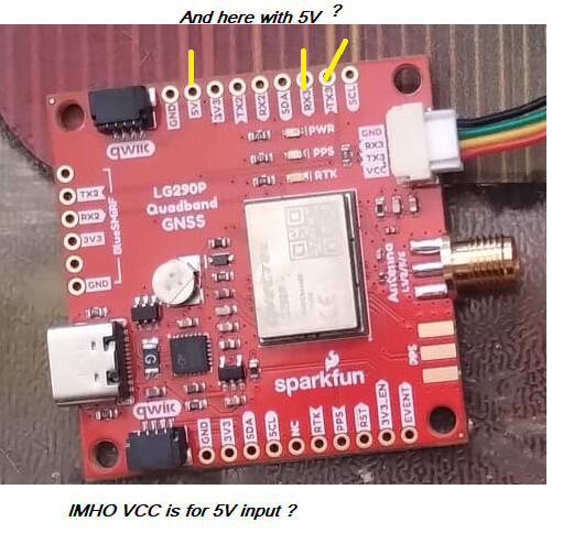

By default the 4-pin VCC pin is 3.3V. With care, it can be used for input or output.
There is a jumper on the back of the board which can be changed to select 5V input.
@bamarcant, the oscilloscope measurement was done from the PTH’s.

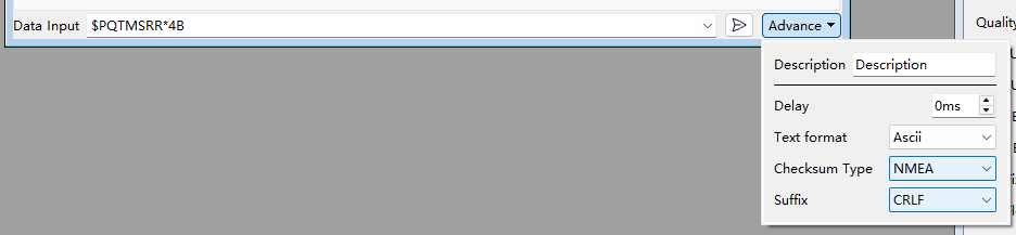

Please also check you have Ascii, NMEA and CRLF selected in the “Advance” option:

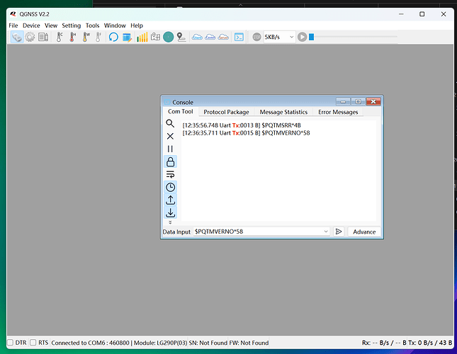

The three commands were sent from UART1, without a reset between the commands.
I just copied the command confirmations in here.
This is what the console looks like with UART1:
